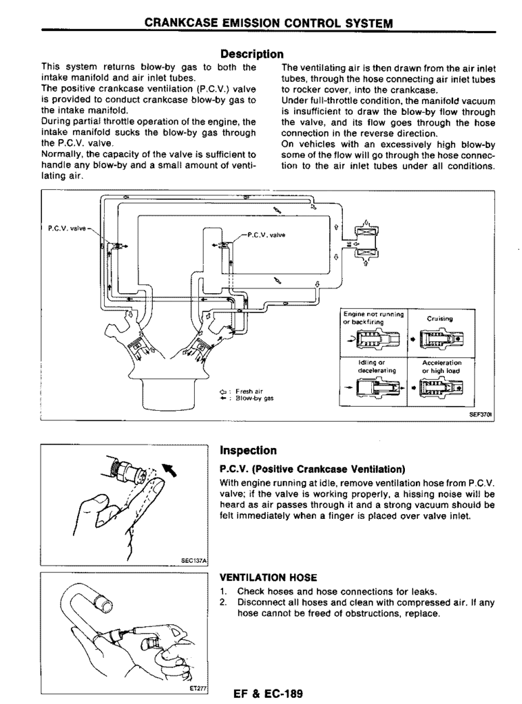

PCV flow diagram
Is there such a thing as this around somewhere? I could be doing with a look at the setup before I do some things and make matters worse!
Thanks a lot for that guys still a bit confused on going about this pcv reroute/bypass think I'm gonna start to pull the plenum to make things a lot easier :)
never heard of a PCV reroute, you sure you don't mean the pipes under the plenum being bypassed??
Nah Vijay have a look for another thread started by me named "pcv bypass" I'm in the process of it but find the Zed's idea of PCV complicated and confusing haha!
