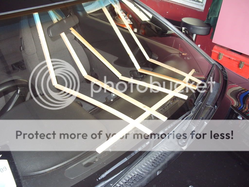

Wow good work getting all that done mate and getting your dash vents stuck down, I have this problem to with the plastic around the vents lifting in my blck zed and have tried to stick it down but with only limited sucsess, to do it right it looks like take the dash out or remove the windscreen, hears how I tried to do it.
wow that looks fun to set-up!:hammer: it was expensive to get someone to remove the windscreen and then replace it monies better spent on the Z i think, had to replace the heater matrix so thought it would be easier to do both jobs at the same time and think its the best way to go.

you would never guess I was a joiner:lol:
:lol::lol:
I didnt realise you were doing the dash Gary, could have given you a little tip i found most useful. I bought an epoxy two part glue, that mixes itself when you press the plunger and because it looks like a syringe, i stuck some windscreen washer pipe or similar, about 6 inches, so you bend the pipe to the angle to get it under the lifted parts of the dash as you press the plunger, simples :turned:
You could have used tennis balls wedged under the window to a straight edge to hold it down while it sets overnight, however you could have still used your scaffold technique :tt2:
