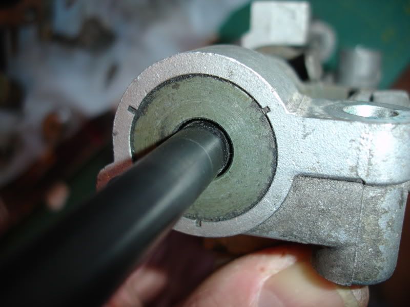

Right, has anyone ever removed the spindle that runs through the front throttle housing?
I am guessing that those 3 indents on the edge of the casting are perhaps holding the main bush/insert in place?
Is it a case of just grinding off the tab on the indent and then pressing out the bush? :hammer:
I need to get this out as the being steel it will not go through the Anodisng process.

Never done one but like you say that looks peened over,so have a go!:thumbup1:
did this on my plenum,
yes, you're bigh, once the 3 tabs are out the way, the bush can be pressed out
Cool, cheers guys. All I need now is a press :huh: or will it be possible with a bit of brut force and a :smash: ?
bit of brut force, a big hammer and a drift should see it pop out nicely :)
