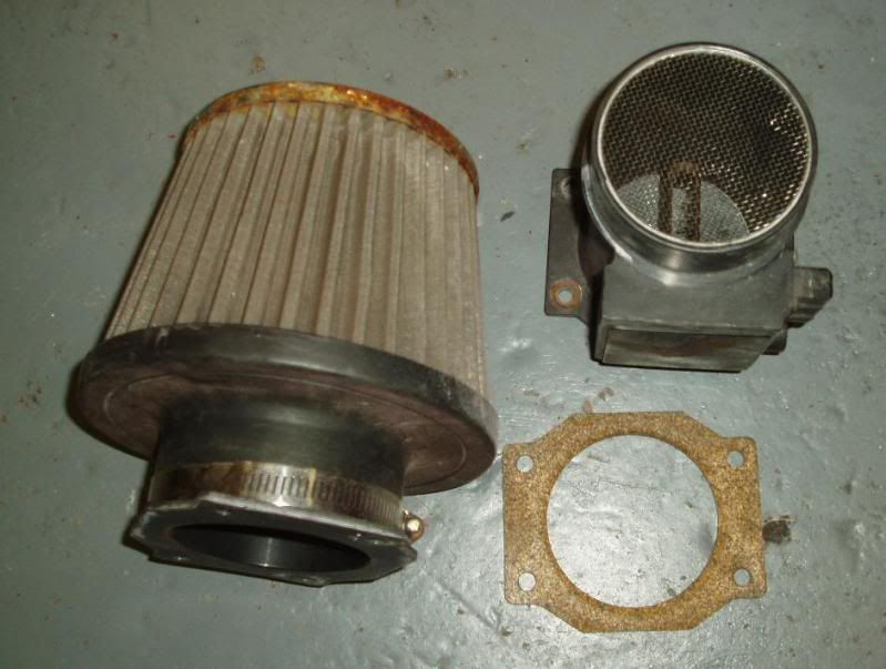

An opportunity presented itself the other day so grabbed the camera to demonstrate this phenomena,the first pic. shows the unit split into three parts, the filter and adapter, the seal and the afm itself.
Nothing too high tech, looks about the right size and shape, not keen on the fine metal filtration material but looks in reasonable order.
Oh and to just add, the zed in question would run fine around town and when on a steady run on the motorway, and when cold would boost and respond well, however when fully warm and the loud pedal was used fully this zed became a bucking bronco! and with NO error codes.

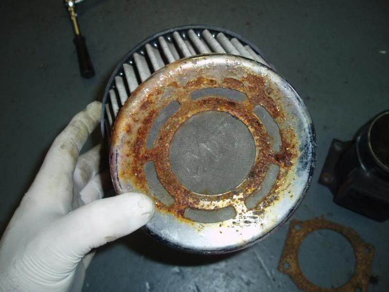

So on to pic. two, the unit end section is very corroded which is not an issue in itself other than to confirm this filter has been getting very wet! again from experience not fond of end on filters as this can lead to air flow issues.
