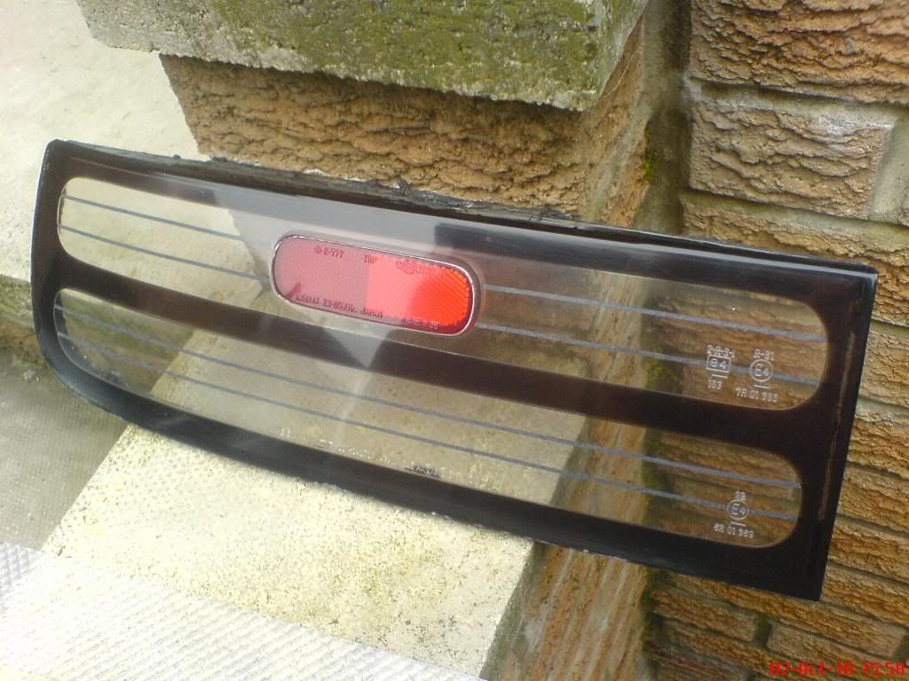

The two inserts were not the same colour, at some point a new rear lense as been fitted, I did not notice this when on the car, both now sprayed silver
As the new clear lenses are not a tray shape like the oem orange ones, you just need to spray up the bottom lip as shown in this next pic, I did it in the same silver colour as the inserts. Put the new clear lenses in with simple blobs from a glue gun.

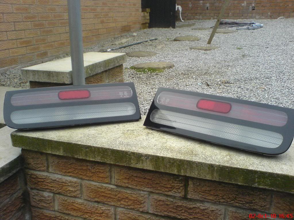

Then I used this 2mm tape http://cgi.ebay.co.uk/ws/eBayISAPI.dll?ViewItem&item=260667923971 and applied to the inside of the lenses, because it is the sticky side out that is showing, it gives a grey colour as opposed to black, you may want to locate something different but I was happy with it.
Make sure everything is spotlessly clean and re-assemble, again if you keep warming in the oven you can just keep going round the unit squeezing with your palms, eventually it goes back as it was before

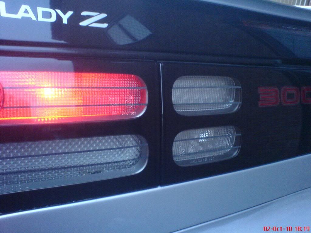

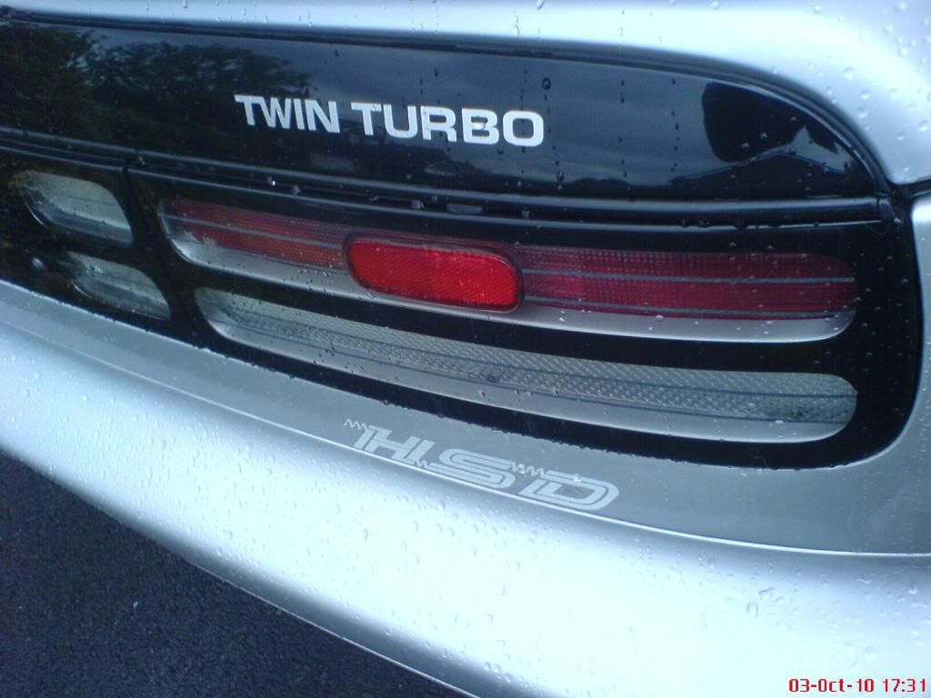

After giving them a good polish, I did fit them at this point, don't forget the orange coloured 21w indicator bulbs!! After looking at them for ages, the idea came to me to open up the centre panel (again) and put the 2mm tape on there to match
Now all back together with no fitment issues, showing the fog and reverse lights lit up bought from Zedwizz(Martin)
The job took me a full afternoon but is very worthwhile, I am pleased with the end product
Total spend = £10.00 :thumbup1:
