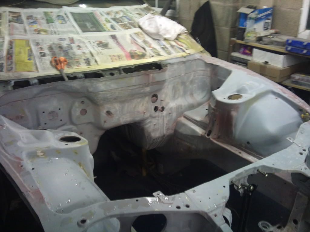

bit of an update for tonigh but no photos as its a bit boring. ive been cracking on with sanding down the high build and got about half way round the engine bay. its a swine of a job as there are so may complex curves and tight spots.
for those that dont know the basic technique is to apply a dust coat of a contrasting colour to the primer as you can see in my last photo. you then keep on sanding untill there is either no red (i used red as the dust coat) or you break through to the etch/metal underneath. if the latter occurs you have to re apply some etch over the bare metal and then more high build locally over the area. when all the dust coat is gone and you still have paint all over the area you have in theory a totally flat panel ready for top coat.
im using 600 grit wet and dry paper and in this case im using it wet. if you are using a none 2k high build i would advise using it dry as celulose based single pack is hydroscopic and you will end up with water under your top coat which will result in blisters at a later date. that is unless you have an oven.

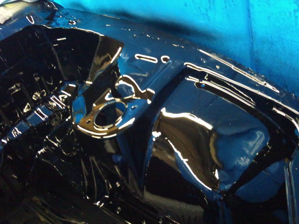

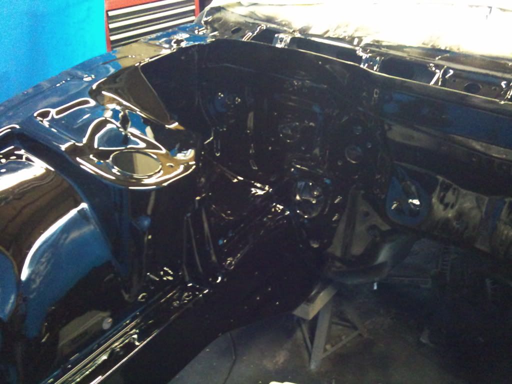

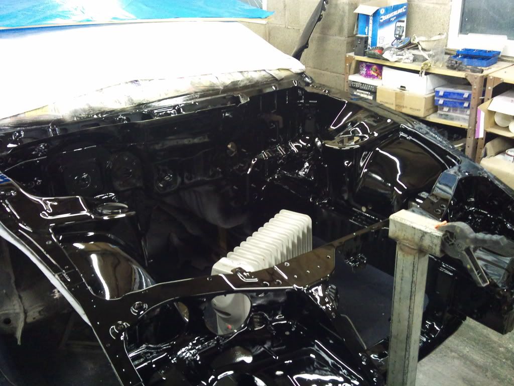

i spent a good few evenings this week sorting out the garage and trying to get rid of the dust etc. this morning i decided to go for its as it has been nice and warm. first off i built a kind of light plastic sheeting bonnet to cover the engine bay after spraying then put up some more plastic sheeting around the engine bay to keep the dust down.
next i gave the bay a wipe down with pannel wipe then left it to dry off and heat up a bit. i have put an electric heater in the middle of the engine bay to help the 2k go off in the not too ideal temps.
mixed up the paint, tack ragged the engine bay then set too.
a picture is worth a thousond words etc so here you go
a few runs and a bit of dust in the paint but im very happy with the results, its having a bit of a bake now under its blanket
there is just too much shiny black there at the moment, my camera phone does not take the best pics for this type of thing.

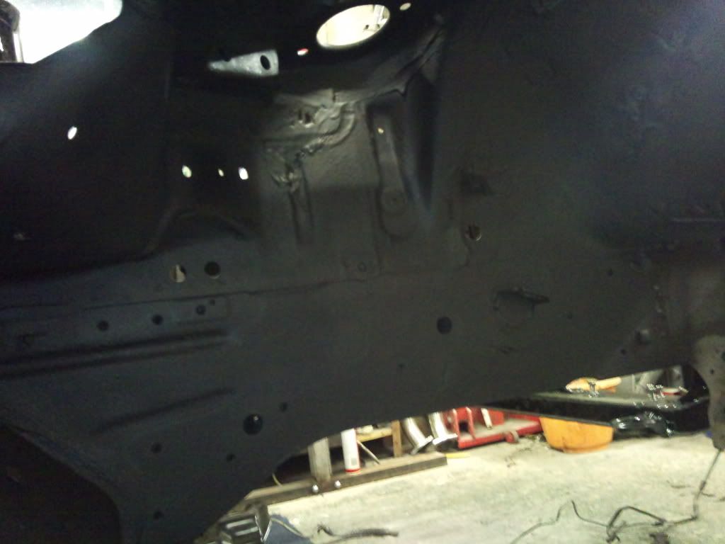

last night i cleaned up the drivers side inner arch and applied some stone chip except for areas that will have suspension etc bolted to them, they get a coat of hammerite over primer. here is the wheel well
other side will follow later this week but it is a horrid job.

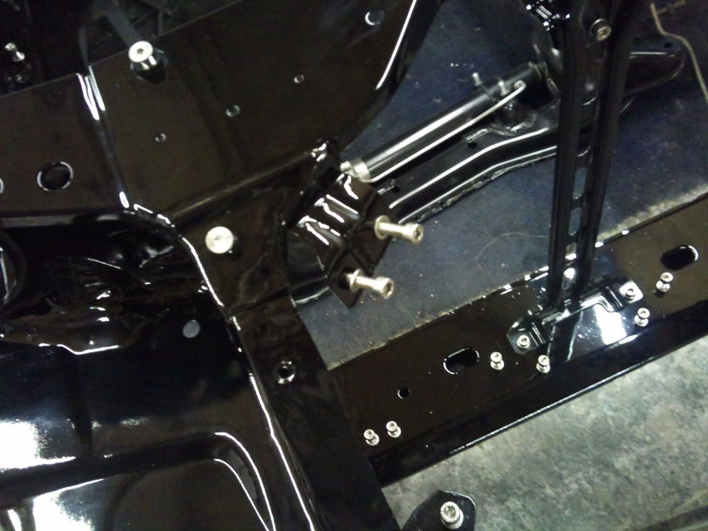

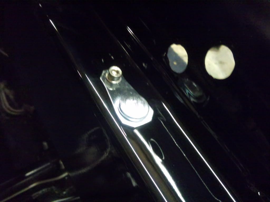

ive been treating myself to some stainless bolts and some black anodised countersunk washers etc, the cost adds up quick but the finish is well worth it. here is the new pas pot mounting with its new bolts.
as you may be able to see, the black countersunk washers dont really stand out that well on the black paintwork so i think ill keep these for mounting chromed and silver itens to add a bit of contrast, ill order a set of silver washers with black bolts for mounting the wings etc.

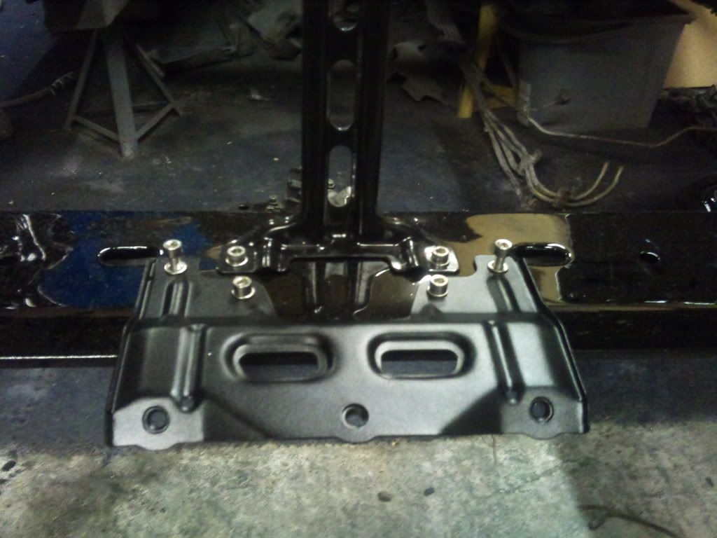

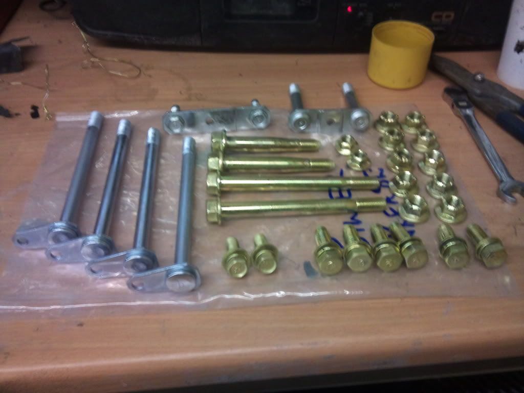

finally here are some of the front suspension bolts back from the platers, quite happy with them really. the fasteners that are visible from the engine bay have been wire brushed (with electric drill) pollished, bright zink plated and then lacquered where as the rest were wire brushed back to shiny metal then brigh zink plated with a yellow passivate and a light dusting of laquer.
here is also a quick trial fit of a subframe bolt with a stainless allen bolt and washer
