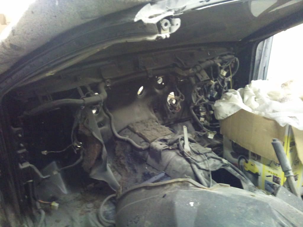

engine bay was taken back to bare metal, this is just about the last of it

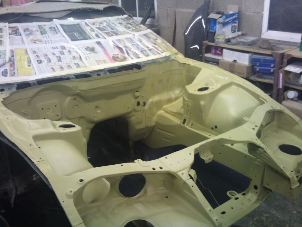

Alot of work has gone on in this area, the battery tray has been removed which revealed a few holes where the battery had leaked, the upper suspension mounting had also had a bit of a bash at some time and had distorted the reinforced panel. i cut out the whole panel in this area and replaced it with one cut out of my breaker. all spot welds drilled out etc and welded back to look factory-also checked to correct chassis dims. you can see which panel i mean as its red (weld through etch primer)
same goes for the passanger side, i have replaced the headlamp pod aswell, it had been repaired to a good standard but i was not happy, it would appear my breaker had a bad bump (bent the chassis rail) but they had replaced the headlamp pod with a new nissan item so this was grafted onto my car aswell. all looks perfect now. the fusebox will go under the nose panel on the inside of the chassis leg opposite the pas pot

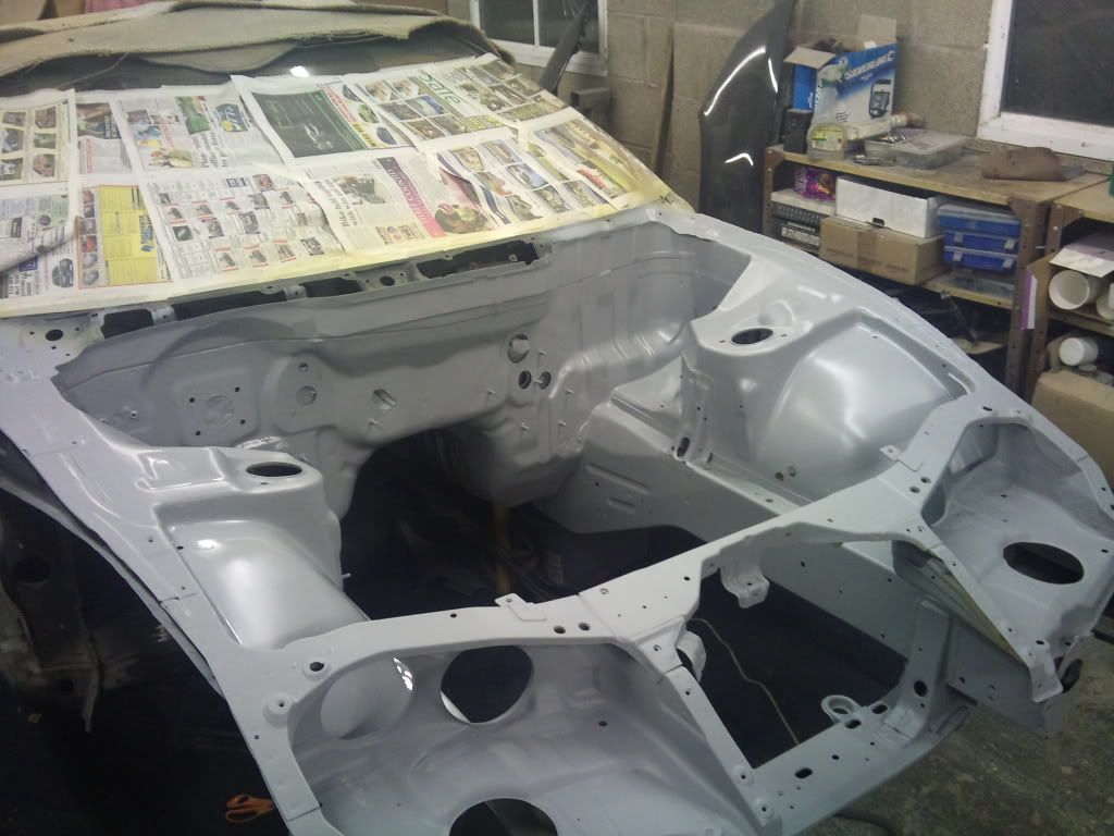

tomorrow i will spray the bay in a final coat of etch, then seam seal a few bits. might even get on to giving it a coat of 2k high build. Colour will be pure gloss black. im going for a very stripped out look in the bay, no wires showing and nothing but the engine to see. colour scheme will be stricktly black and silver/chrome/pollished aluminium.

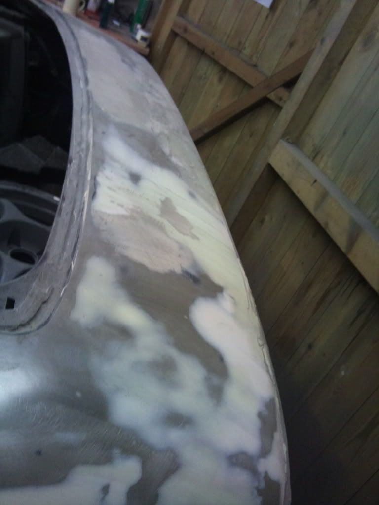

rear 1/4 with antena welded up all ready for high build

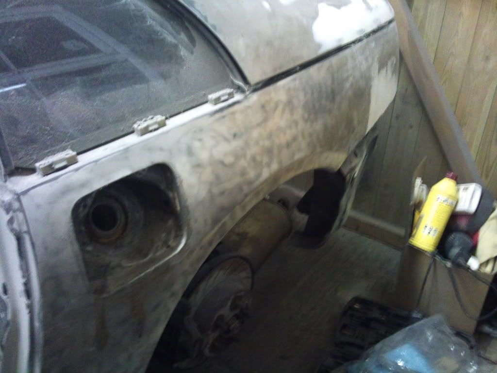

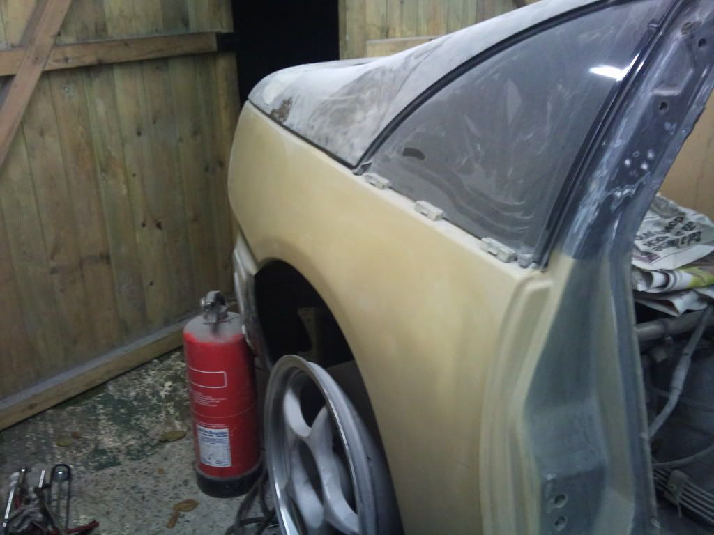

passanger 1/4 still needs some work

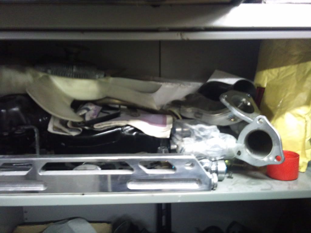

some goodies in the cupboard ready to fit

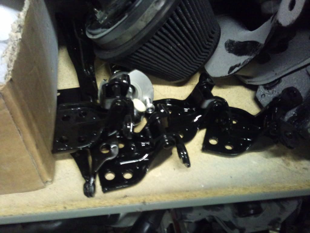

all hinges sprayed up gloss black ready to fit along with the mirrors and handles (in the box)

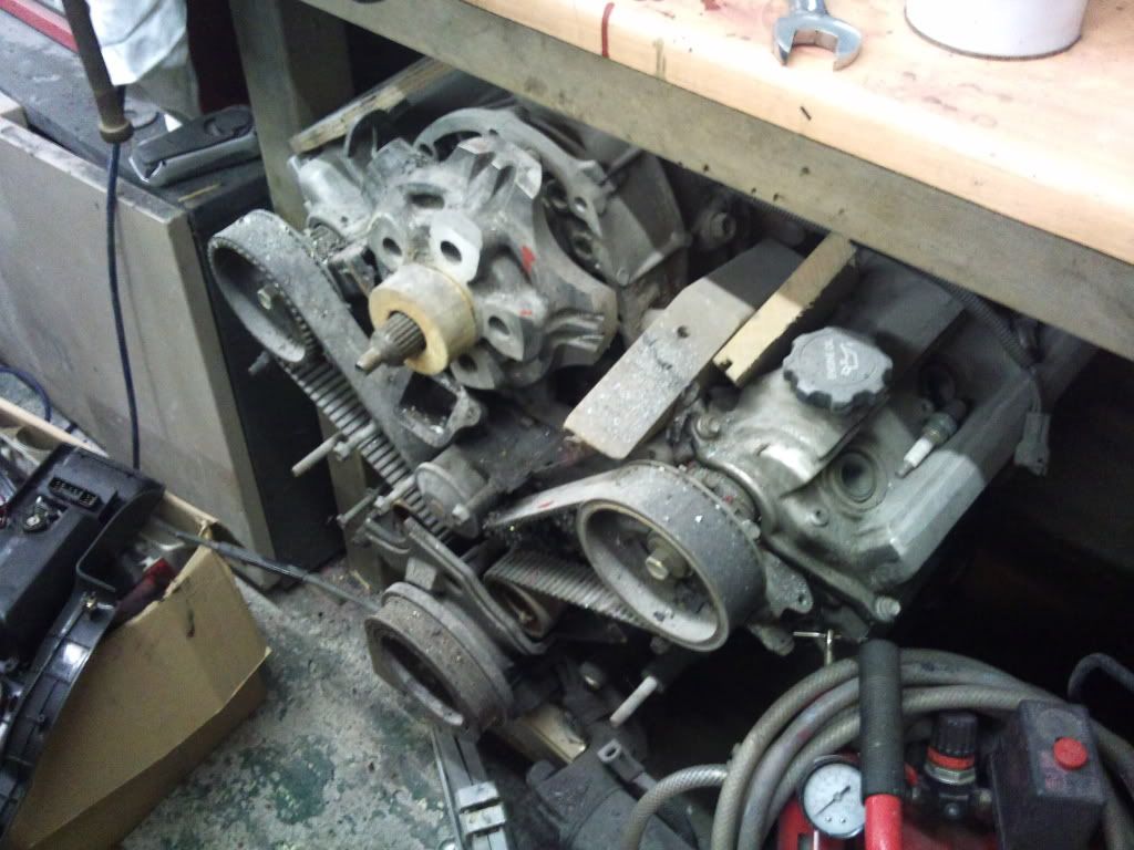

tempted to fit this- lexus v8 being adapted to run two t28s

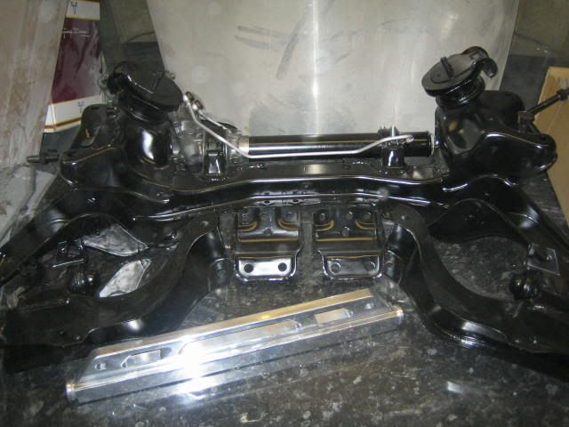

all front suspension shot blasted and painted 2k satin black

The v8 is a lexus 1uz from an sc400 or sourer std they make about 280 bhp but are very restricted.the engines are enensly strong and even put nissan engineering to shame. its all alloy with 6 bolt mains, dohc with one cam driven of the other by a gear. its very light for its size. Its actually a supra gearbox sitting on top without the bellhousing but it does look alot like a supercharger, which you can fit there.
my plans for the engine are to either twin turbo it using some gt28rs' or a big single holset. the fantastic thing about the engine is its ability to resist detonation. you can run about 15psi on decent sized turbo with the std compression ratio meaning you dont loose and of the engines emense low down grunt and the turbos kick in real early. i will probobly use water injection with it to.
power would be in the region of 500-600bhp but with epic torque.
it was going into my s14 which is a longer term project put on hold while i "tart up the 300"
getting a bit tired of working on the car every evening now so once the 300 is done with the vg back in i might just work on the v8 when i feel like it and see which car i feel like putting it in.

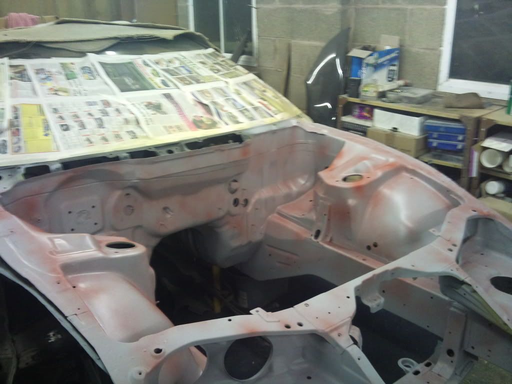

well got the engine bay finished and sprayed in etch today followed by a little bit of seam sealer where needed. no photos though as my camera died.
tomorrow night should see some 2k high build on there followed by an evening of rubbing down. should be good for top coat by next weekend, also need to polish/clean up the suspension bolts that show through in the engine bay so the front suspension can go back on and make the car mobile.
ill post some pics tomorrow
well a few updates for today
after getting on a coat of etch last night and some seam sealer i sanded off the excess sealer and reapplied some etch over the sealer
left to dry for a few hours i then mixed up about 1/2 liter of 2k high build got out the airfed mask, gloves and suit.
20 mins later and this is the result
left to dry for another hour or so and on goes the guide coat
so tomorrow night once this lot has been left to cure ill be getting out the wet and dry. still hope to have the top coat on this weekend, perhaps even get the subframe on etc but still got to finish under the arches.
now im off to bed
