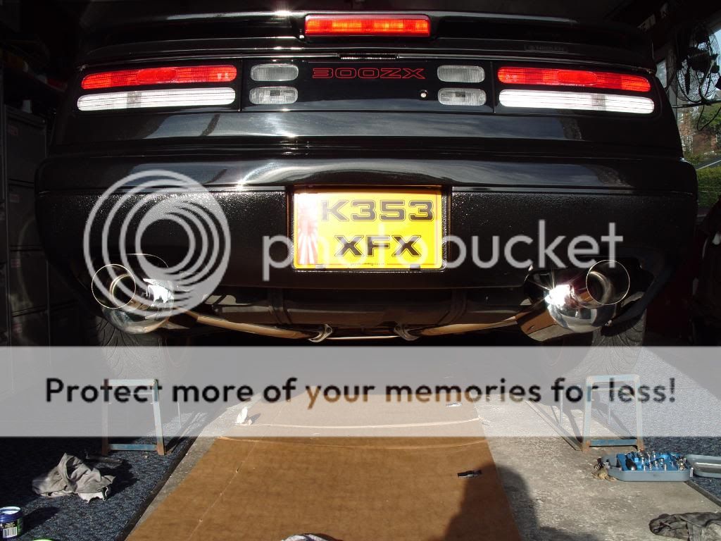

i just made two 8 feet ramps tp hook over my ramps and the car still only just clears . once jou get it on the ramps a good high lift trolley jack under the diff so you can get a couple of concrete blocks under the back wheels . its not a nice place to be lying on your back under a car but this will give you about 2 feet between the floor and the bolts
