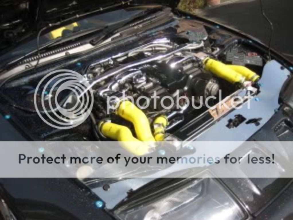

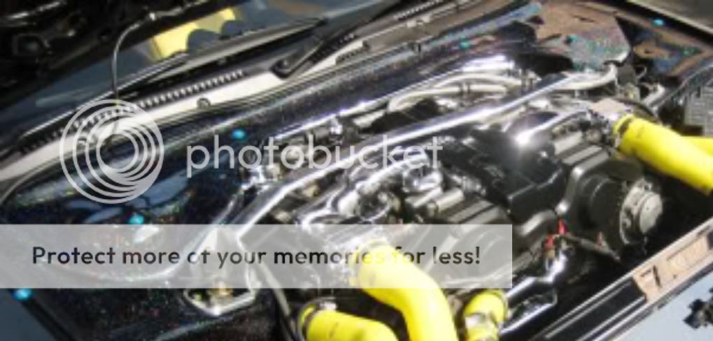

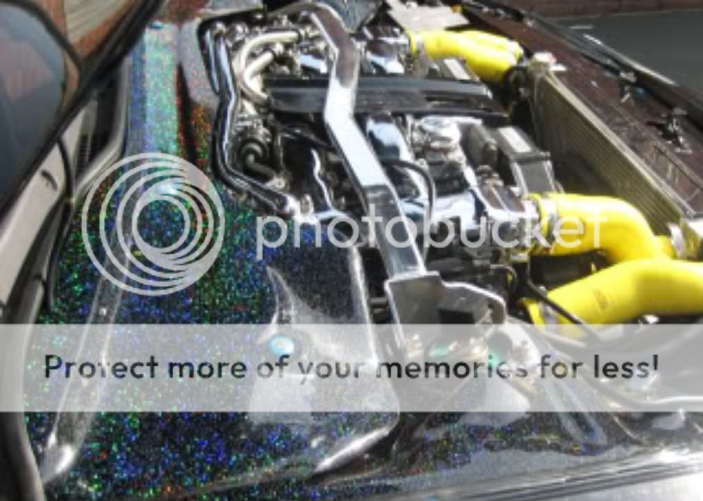

aww...I thought this thread was going to be about people that really like Engine bays
Me too. Thought there'd be loads of shiny engine bay pics to ogle!!
