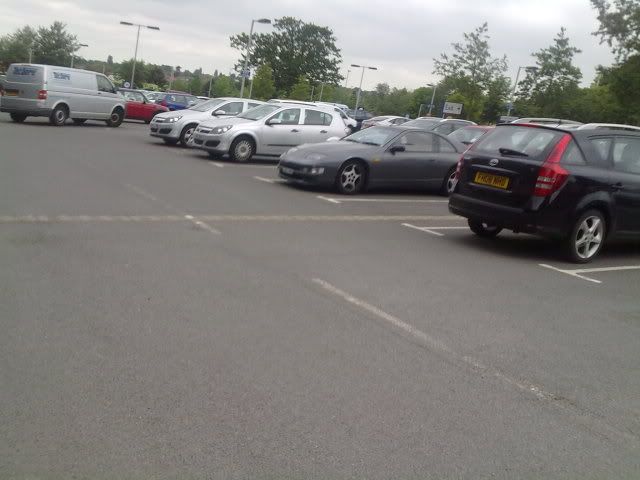

Spotted this ZX in the Sainsburys. Oadby car park today about 16:00hrs, my partner says she has seen it at Sainsburys Wigston, so I presume you work for Sainsburys?
