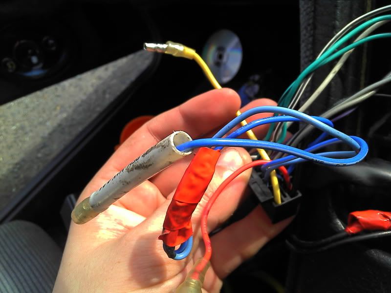

OK. ive found my stereo has the yellow wire with the click together connectors off. reading up it seems this is the Constant 12v power. where should this connect too? its not the blue loose one that has a 3amp fuse is it?
cant see any connector on any loom to connect this too :(
Edited by damien
Blue one is normally a remote wire. Take a feed off something that has a constant feed like the hazards switch, lights etc
Ok buddy. But i must admit.... how the hell did i have my old stereo running with just a wire going to battery
scotch lock the red wire to the yellow. one working radio.
