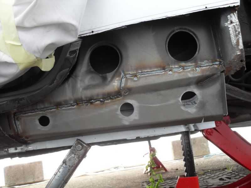

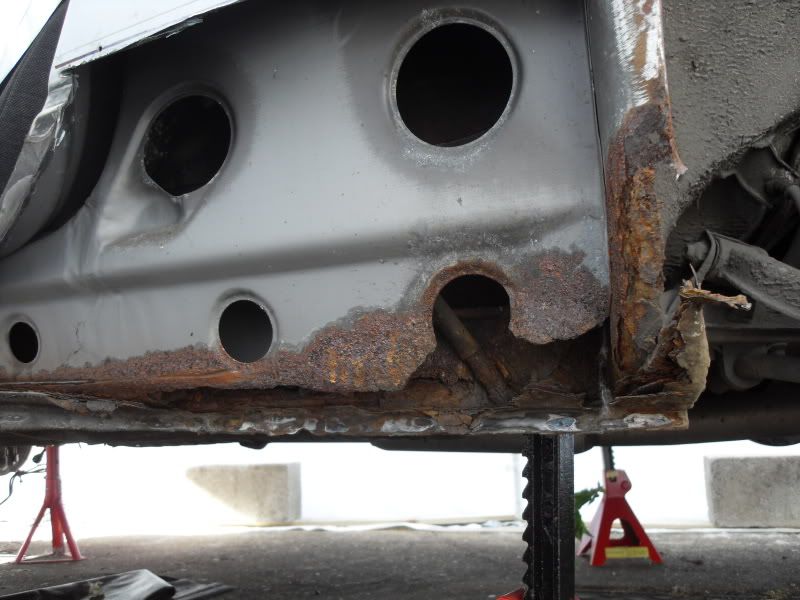

I,ve took this week off with the intention of getting all the welding done on the zed , two days in and one sides done

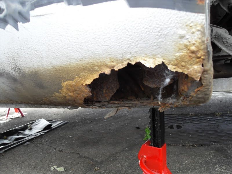

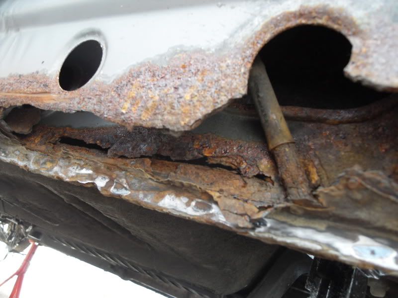

Cut the sill section off to reveal

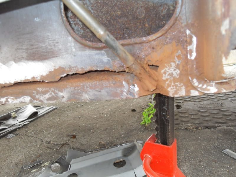

Then cut the inner panel back to reveal

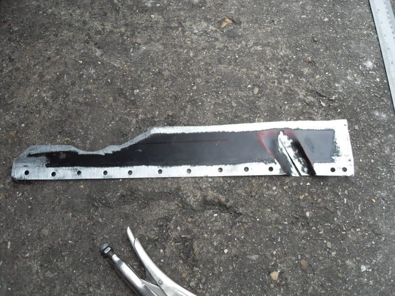

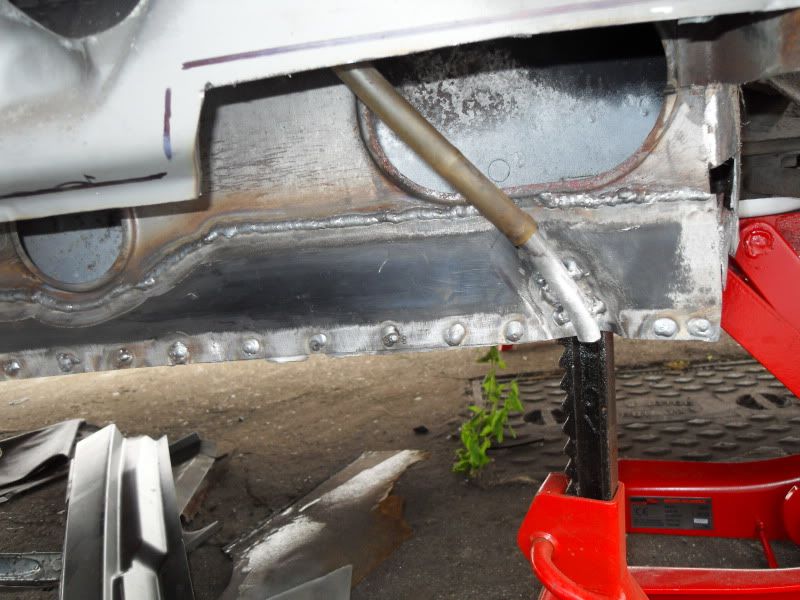

So i made a repair section and a new drain tube
Then sectioned the inner panel

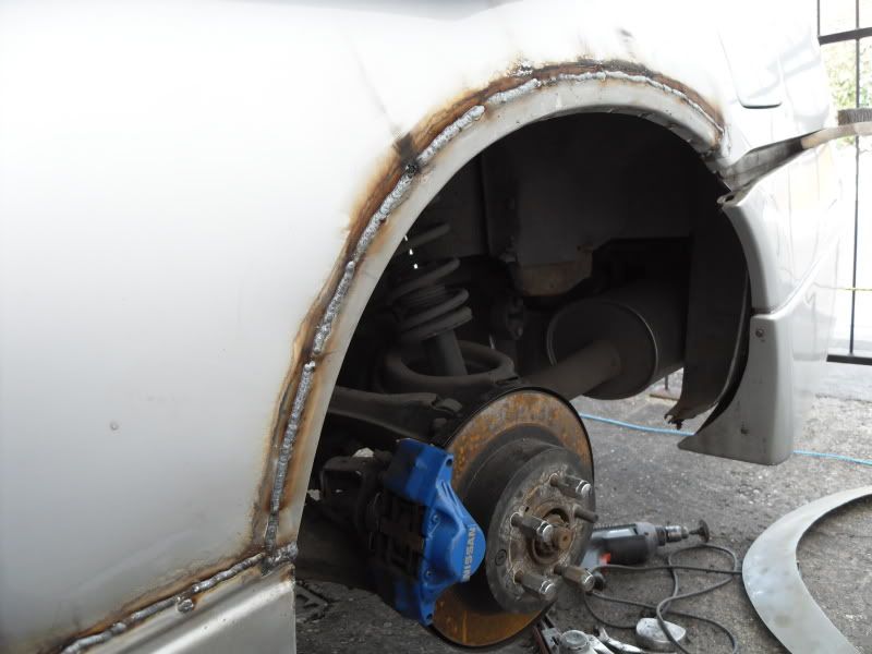

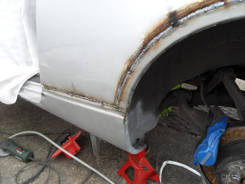

Then the outer sill section and cut down the repair arch to as little as i could use as the arch only had one section of rot on it but i thought it best to fit it all anyway for peace of mind
Just the other side to do now !!!

i was thinking that too jimmer..... top job matey, very neat!.... what's the next step? flatten all the weld and a bit of bog and hey presto?
beautiful bit of welding!
know where to take mine if i ever need it doing!!
Out of curiousity,why did you seem weld the arches on bud?
If it,s just stitch welded your leaving a gap inbetween the welds that moisture caused by condensation forming on the inside of the panels could penetrate and start rusting again even if it,s waxoiled theres always a chance of not covering it all , i,ve always seam welded arches to eliminate any chance of this happening . HTH

Has that rot been caused by the Targa drain leaking ?
i never got why nissan ran a plastic pipe down that runs water out and attached it to a metal pipe at the bottom
there is also a rubber pipe that drains water off into the front rad support bracket
Nice job :thumbup:
I don,t think it was , they do have the odd hole here and there for grommets and drain holes , i think as well as letting water out if your in a real downpour water will inevitably get in and with acceleration the waters gonna get pushed as far back as it will go which is the back of the sill area then when it warms up condensation will form especially around the wet area , hence why it rots from the sill up normally .Well that,s my theory anyway .
