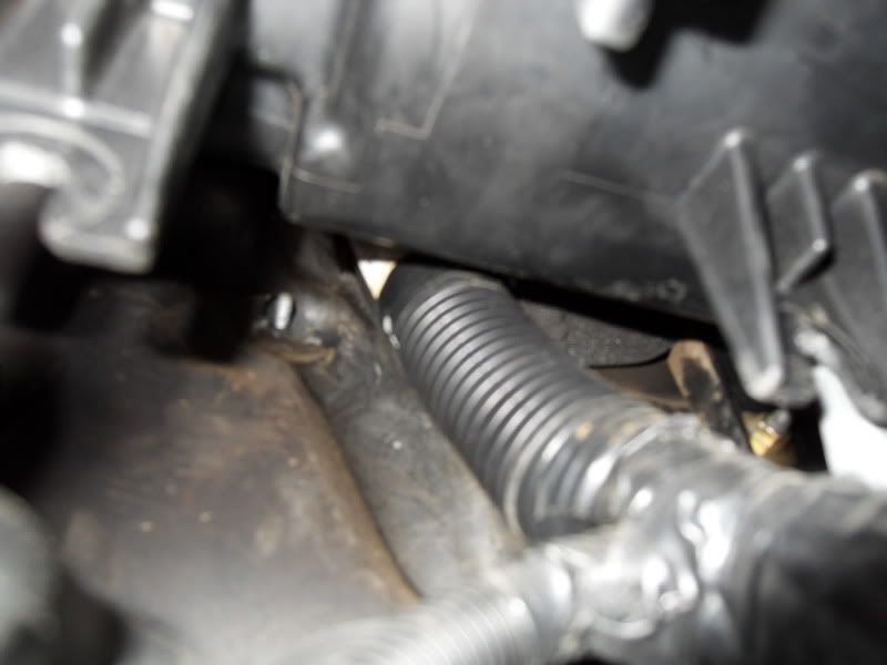

As mentioned bud you do have to remove the glovebox and then i removed the aircon unit behind to gain easy access but i,ve junked the aircon anyway , heres the bracket that secures the loom to the inside of the bulkhead above the ecu,s ..

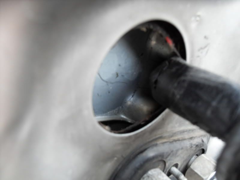

The offending bracket as seen once you pull the loom and grommet out in the engine bay

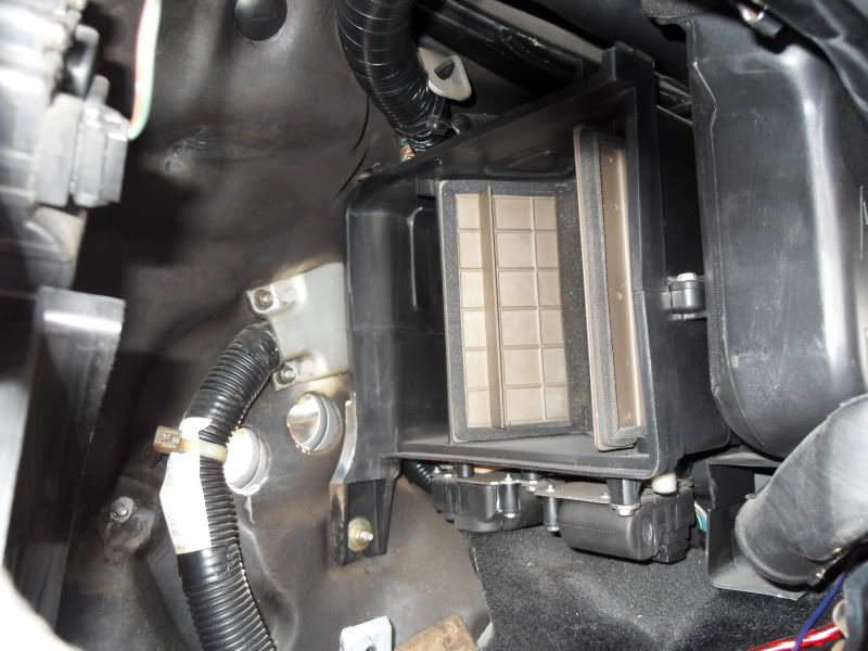

This is the aircon unit that,s behind the glovebox , as i said i removed mine easily cos i,ve junked the aircon , how you remove this when the pipes are still connected through the bulkhead i don,t know without draining and re-gassing the system . there, wasn,t enough room to try and reach up behind it to undo that bracket and release the loom off the inside of the bulkhead .
