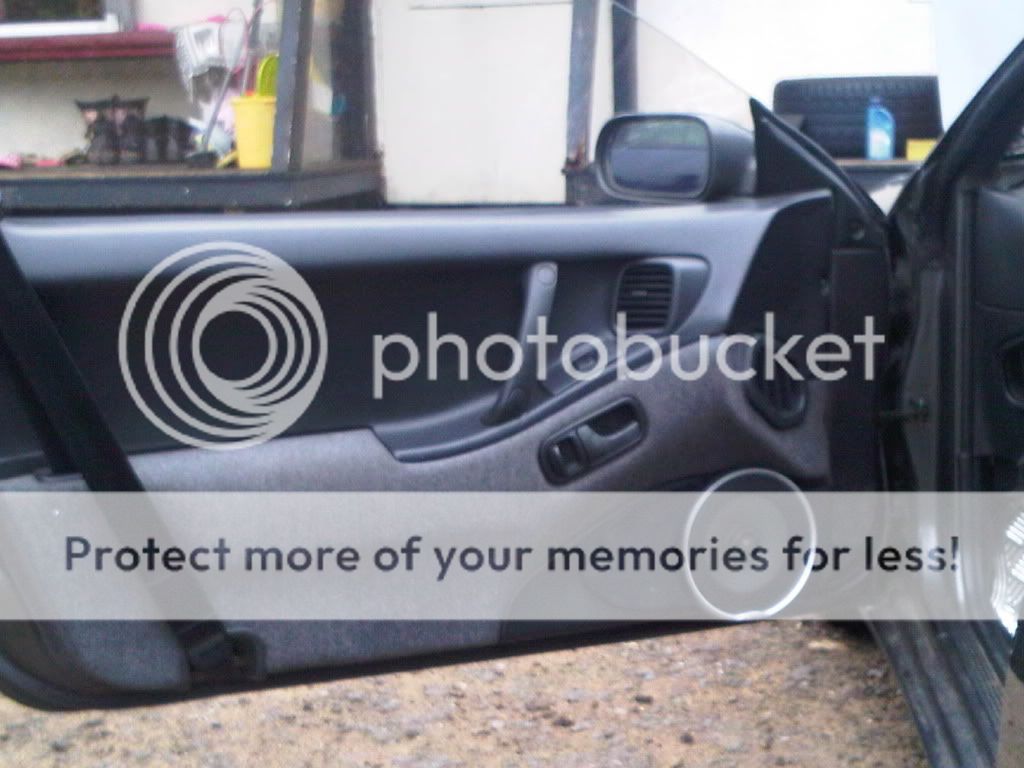

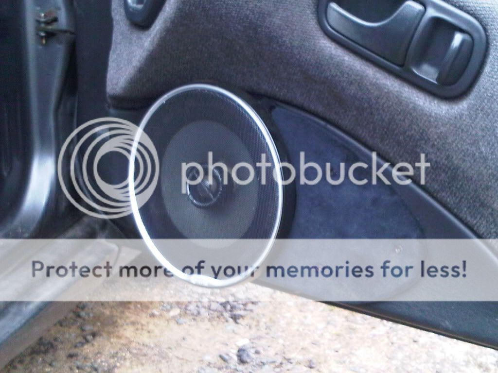

Heres the badgers, don't seem to have any photo's of the tweeters. could of swarn i took some.
First attempt
DSC00138.jpg[/img]
Final attempt
DSC00137.jpg[/img]
It doesn't look perfect, but i really didn't want to start cutting bits of the metal framework out to fit the 6.5's or to fit some 6x9's in the doors. (i have seen the latter achieved, and the result does look good)

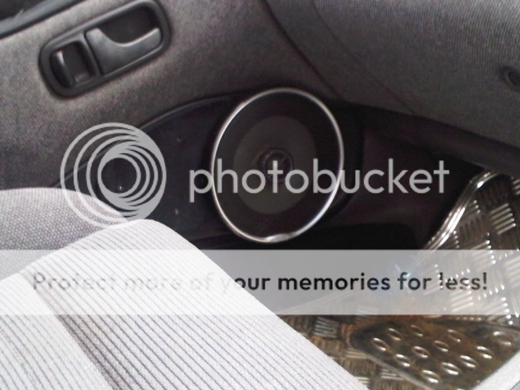

I got some shots of the door speakers with the gap covers on for you to have a look at

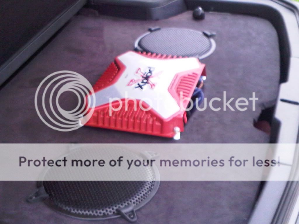

And the parcel shelf
I didn't want to do anything that changed the car from standard, so I fitted 16 cm fronts and 6"x4" rears in the end. I used a sub in an MDF boot floor, that came with the car. I powered it using an amp under the boot floor where the jack usually goes.
