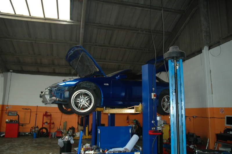

As you are aware its hard to find one without getting it from Z1 (my last choice) got some piccies up though!
well chuffed apart from missing a clutch booster to whihc the guy who sold me the conversion said it had it. I thought it was the fluid resovoir, I was told its the black circular thing but i remember that being attached to the pedal so it cant be that missing
