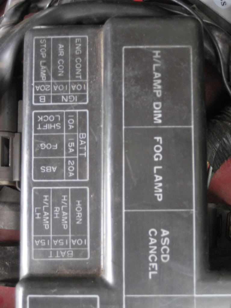

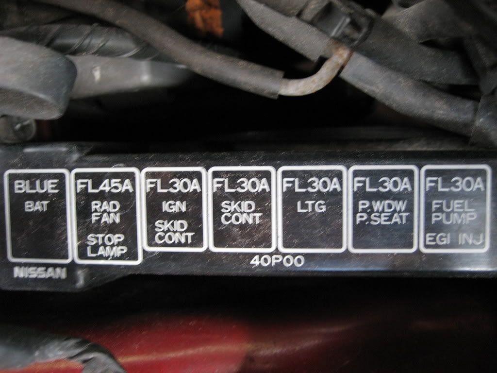

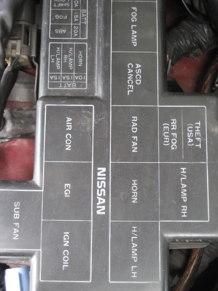

I did a search but I couldn't find anything to point to which fuse etc. I have taken the following images from one thread and hopefully somebody will guide me.
I'd guess the fuse is the box in question above located in the engine bay and if it is, would it control all the stuff I listed? Also if it is, what amp fuse should I get?

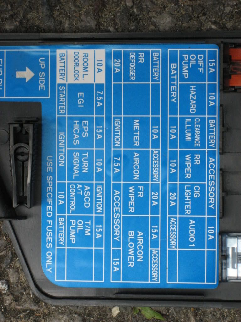

As Car Mad suggested in the link posted by Gary, it was the fuse in the drivers side footwell - top row, third from the left & 10amp.
Sideshowbob - I think that we are talking about the same fuse in the footwell.
sorry to hijack, but what is the skid control relay for? was esp an option? sure i heard that somewhere...
