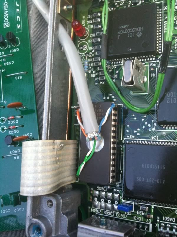

Whilst dealing with my non running issue, I noticed this sticking out of my ECU

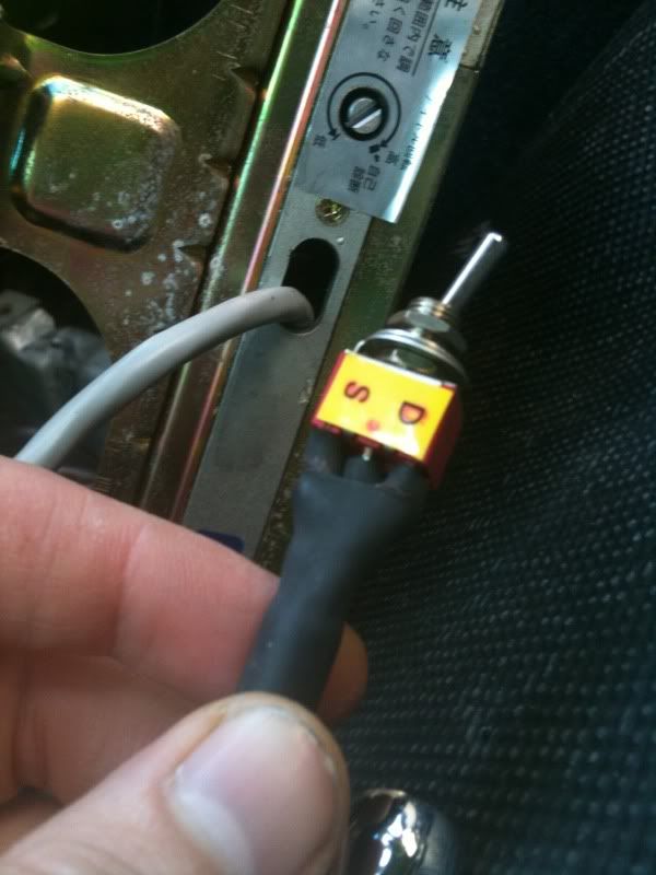

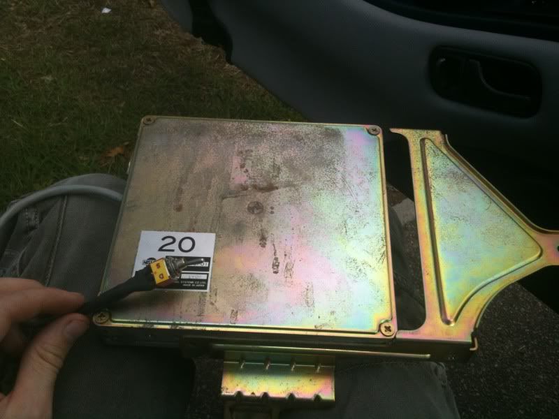

Coming out of the hole in the ECU housing was a wire with a switch on the end??

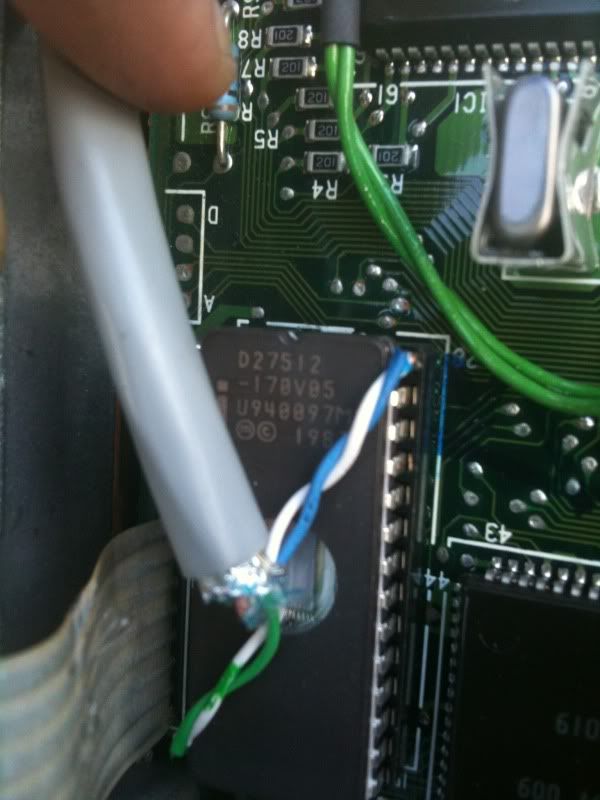

I pulled it all apart and found the aftermarket chip that had been wired in by either Apache or whoever he bought it off, (I didn't even consider that it would have been installed within the ecu..) and this switch was wired in on three of the terminals, but I have no idea what its likely to be used for..
What is this? could it be for turning off the chip? or switching between two modes maybe? or could it even be used for turning on mode 2 on the ecu without having to pull up all the boards and carpet, and just look at the engine light for the code....?

Aha, now that is one of mine. It switches between two different maps. Can't remember what they were now though !!
As far as I can remember it was a standard map and a Devlin map............hence the "S" and "D" on the switch.
