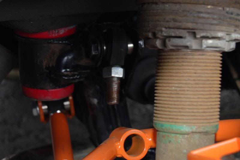

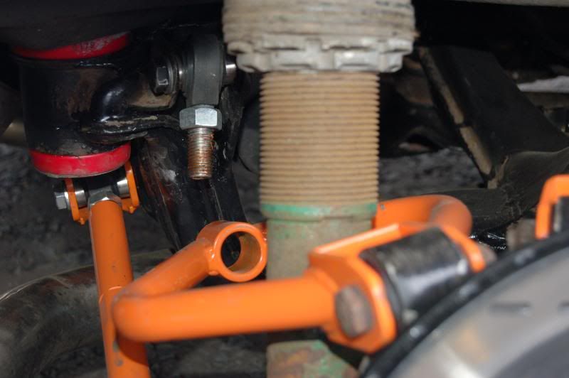

The bearing part seperated from the arm and the drivers side rear wheel folded in and rested against the coilover.

When i get a replacement arm, i'm putting locktite on the threads!
Good call!
I was advised by a couple of the guys on DW to Loctite the thread once they've been set up by an alignment shop
'Royal' who used to be on here, mentioned that the bolts need a bit to stop the nut from slipping during the initial bedding in period
You ought to mention what's happened, to Kam or one of the lads at DW
Im gonna contact them tomorrow to see about getting another arm. I'll mention it to them then.
The annoying thing is, my zed's booked in to have the geometry set up a week on friday. Hopefully, i'll have another arm before then.
