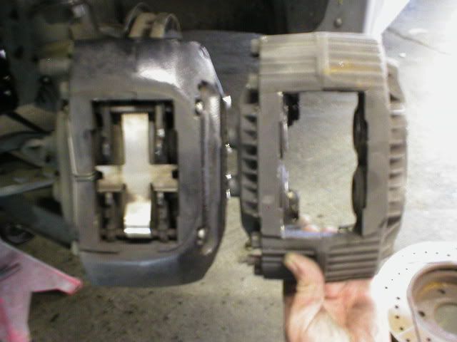

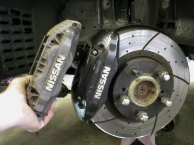

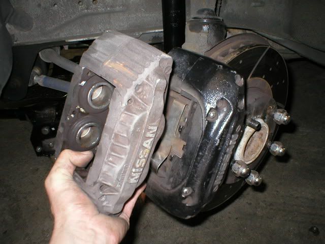

Fitted the front pads to my R33 Sunday with no problems. Test fitted these to a Z32 calliper and every thing lines up ok.
(LEFT) R33 GTS T (RIGHT) JAP SPEC Z32
Only different is disc size R33 being 296mm X 30 mm
