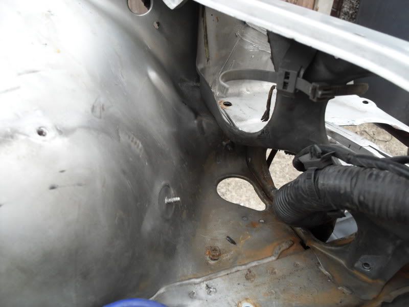

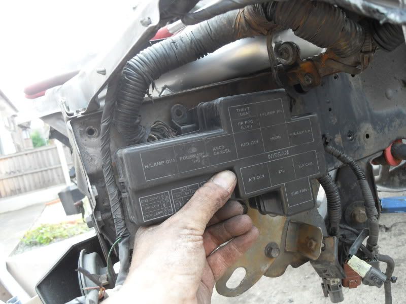

Some people have put the box at the front of the n/s leg but on the inside , i,m fitting a FMIC which has twin air filters so it would be very difficult to get to it to change a fuse .
Having done away with the standard IC,s there was loads of room to the outside of the leg and an easily removable splash shield to gain access .
I had a look where the wiring goes through the inner wing and measured the hole , then the fuse box and realised that it might squeeze through , i needed to unclip the wiring from behind the wing which was off as i,ve got some welding to do but this can be done just by removing the slpash shields
I bent the bottom edge of the hole down a little just to give a little extra room , removed the top and bottom covers on the box also marked and removed the relays , then tried to get it through
and after a bit of juggling it went through !!!
zedrebuild135.jpgAll i,m gonna do now is mount it in a water proof box ( ahem .. tupperware ) with some packs of silica gell to stop any moisture build up .
The only wire i need to extend is the ABS one on the loom :thumbup:
