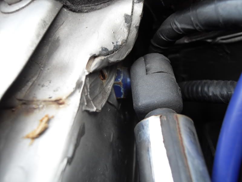

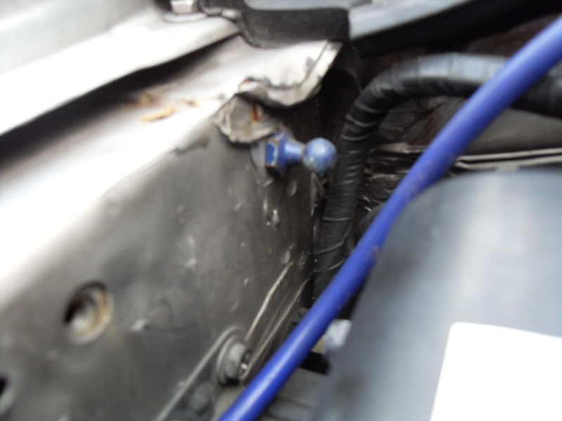

You have to drill a hole in the bonnet underskin and i used the insert where the boost soleniod (i think thats what it is) is located, near the brake servo. When the rain stops i will get some piccies.

I had some issues with the strut spinning at the lower attachment point, so i quickly manufactured this bracket so i could fit and check for clearences. I am getting a machined aluminium bracket made soon to replace this.

You screw the ball straight into the threaded nut welded to the inner wing if you have one with a 5mm thread , i never did find what make and model of car the one i had was from :headvswal .
If not take a normal 8mm threaded one to a friendly engineer and for a couple of beer tokens they would turn it down on a lathe and re-thread to 5mm , saves having to drill and fit a 8mm Rivnut , piece of pi55 :clap::clap:
As for the strut we used tailgate struts of a early Renault Megane hatchback as they weren,t to long and not too strong , bearing in mind the light weight of the zed bonnet. HTH
