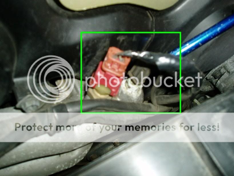

two sensors on the metal pipe in front of the cam belt covers . one has single wire and the other has two .
any pics?? god dam big engines

right so give that little thing a good clean aswell. hopefully get the car stripped proper down tommorow and try fek about with it to sort this annnoying issue
