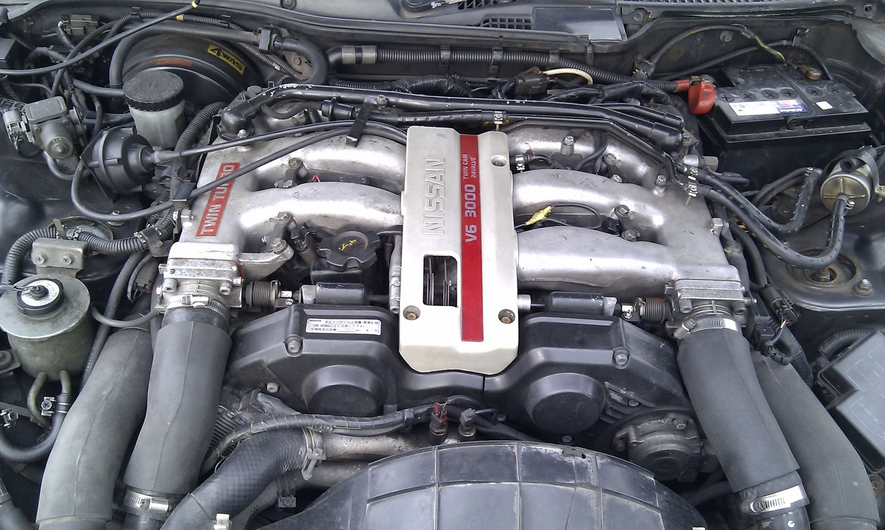

hi im new to forums and im new to the 300zx scene.
i have wanted one for years but have 4 children.
i have recently been able to afford one as i need ti have a family car as well as the new toy.
Im having a few problems tho its a 1990 twin T (auto)
when i accelerate the boost gage goes right up to 7 then drops right back down with no real kick.
the engine doesnt smoke and makes no tapping noises nor overheats
i suspect turbo or vacuum problems as other than this the car drives fine just slower than my 2.0 red top astra :(
any ideas would be apreciated ( already ordered a usb consult cable with software
ta
Rob

Sounds like you have a nasty boost leak. Check all your pipes for splits and they are all conneted up properly. :)
u have a boost leak by the sounds of it have a good listen for any leaks under the bonnet or get a boost leak tester, u may have a hose popped off or split?

1 more silly question what is a boost leak tester :S
ok in simlpe terms it fits in place of the air filter & you hook it up to a compressor for about 10 20 seconds & not more than 7psi (dont quote me on that) then listen for air leaking out as u will be able to hear it better for the engine is not running when doing this test!
there is a thread somewhere on here about making your own tester using a tesco coffe jar lid & a tire valve & it works perfeclty

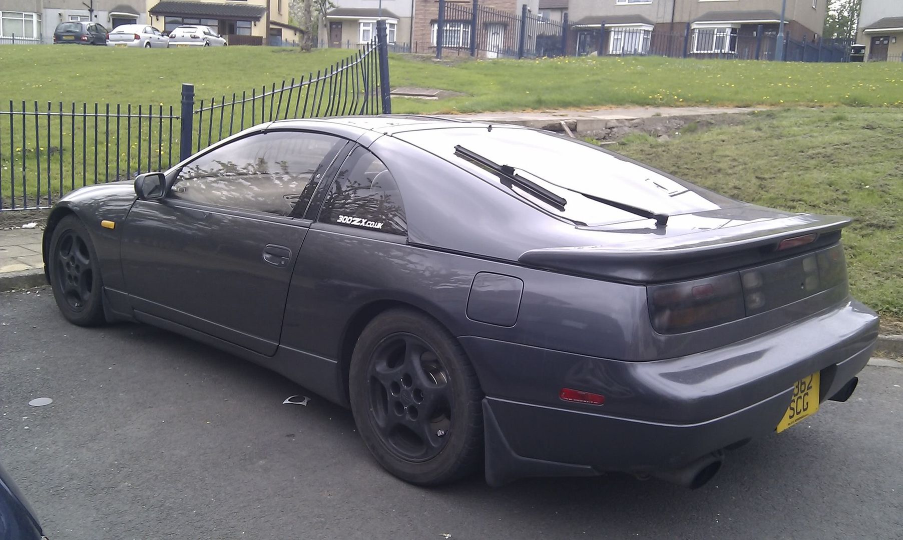

the lights are quite nice :D and yes the exhaust does need cleaning lol i havent got that far yet :D

hmm going to take car to a mechanic i know lol how on earth your meant to check half the pipes beats me looks like the bumper got to come off to check all the way down :(

right i found one leak on the pipe from the intercooler back up ive fixed it by tightning it :D
i have taken for a quick spin and boost seems to be holding fine. mine states it in mmhg
-7 to +7 and it was holding at 3.5 to 4.5 mmhg is that about right for stock.
it doesnt appear to have any bov's but i can still hear a duming noise when i take my foot off the pedal i cant hear owt when foots down as the exhaust system rock s :D its still no where near as quick as my mates stock 3000gt twin turbo and i mean not even close so when i find all the leaks hopefully the power will be restored :D ill post later if power is still down
now quicker than the red top astra so was a major improvement :)
Welcome matey :) Once you get all the leaks sorted it should be a nad quicker than the gt ,depending on overall condition of both cars that is :)
Welcome along Rob, nice looking Z :thumbup:
