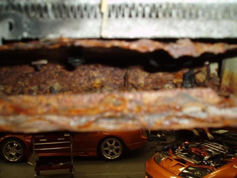

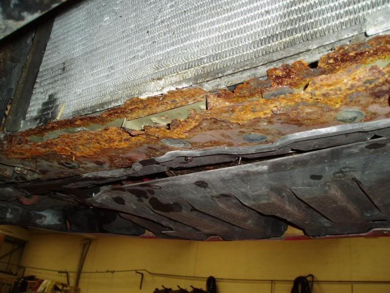

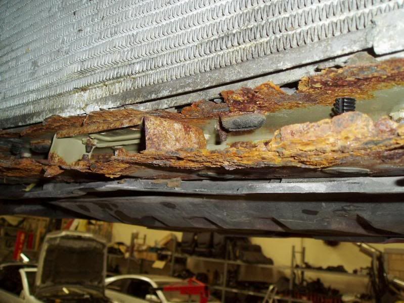

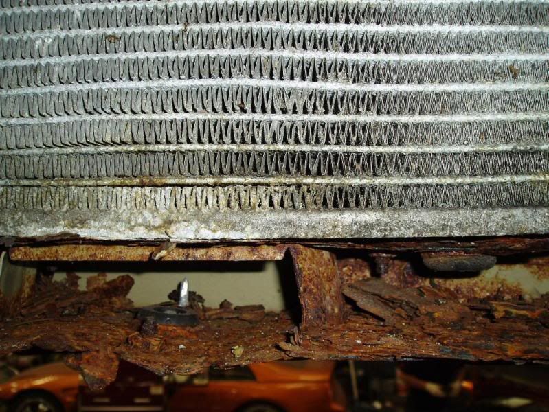

Found during a new owners assessment, bizzare the rest of the zed is tops, done a fair few of these but this is bad, when we get to fix it will do a write up on it with pics.
Was a disapointing discovery for the new owner, to be fair unless jacked up you would not see it, rest of the zed is fine so well worth repairing and not to let it spoil the purchase for him.

Thinks it's the foam Nissan put underneath the rad, just holds water :(

I worked for nissan for 8 years and the micra bubble rots in exactly the same place, doesn't seem to be a reason rest of the car fine. Maybe they use thinner not so well cover metal here as its not load bearing. odd!!
My s13 was the same if not a tad worse

there is a water drain off pipe from somewhere that goes into this and it is open ended, i think this is what casued mine, it was a pig of a job to replace

Noticed it when I replaced my radiator.
