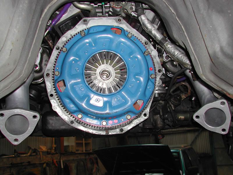

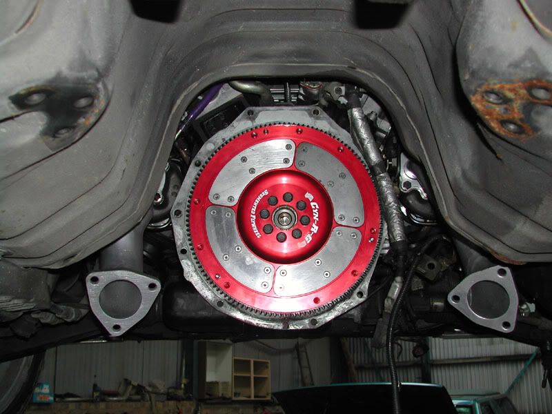

Fook me someones been having a bit of a field day in that car since I sold it. I don;t believe it's actually done that many miles since I had it.
This is what it used to look like.
Stu, it could look like that again with a little clean:blushing:
