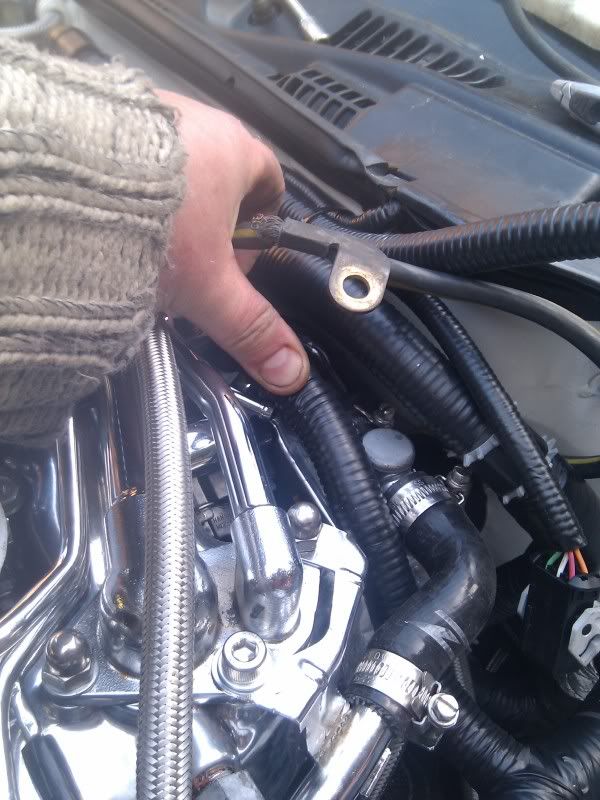

1. There is a pipe that comes out of the fuel rail on the top right hand corner where does it go?

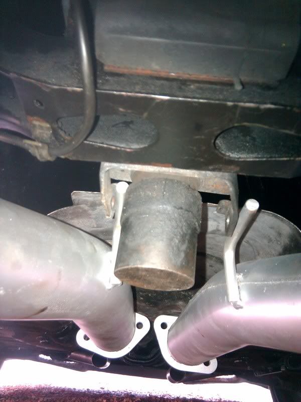

2. I have monster front pipes, do they look like they are in the right position? also I dont seem to have any mounting points or rubbers. Should their be something here on the back of the gearbox?.

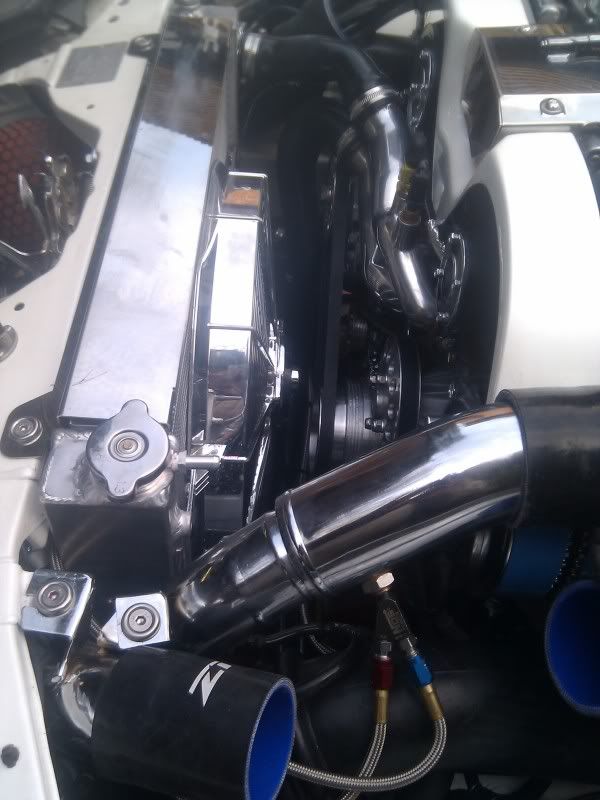

3. In the wheel arch filled behind the battery there is an old coolent top up bottle, it looks like the pipe used to feed into the bottom of the stock rad??? do I keep this and put the pipe into the outlet pipe just under the filler cap on the new bigger rad?.
1st pic you have the hanging mounts missing
2nd the little pipe next to the cap goes to the overflow bottle
3rd Just cap it off or use it for your boost gauge.

the pipe in the third pic is coming off the balance bar, not the fuel rail. this originaly goes to the carbon canistor so if you have no CC, as said cap it off.
the old coolant bottle could well be the over flow, some people move it from the front to the rear to aid with air flow for the IC. the small outlet on your rad in the pic should go to that bottle unless you want to put an over flow tank else where.
