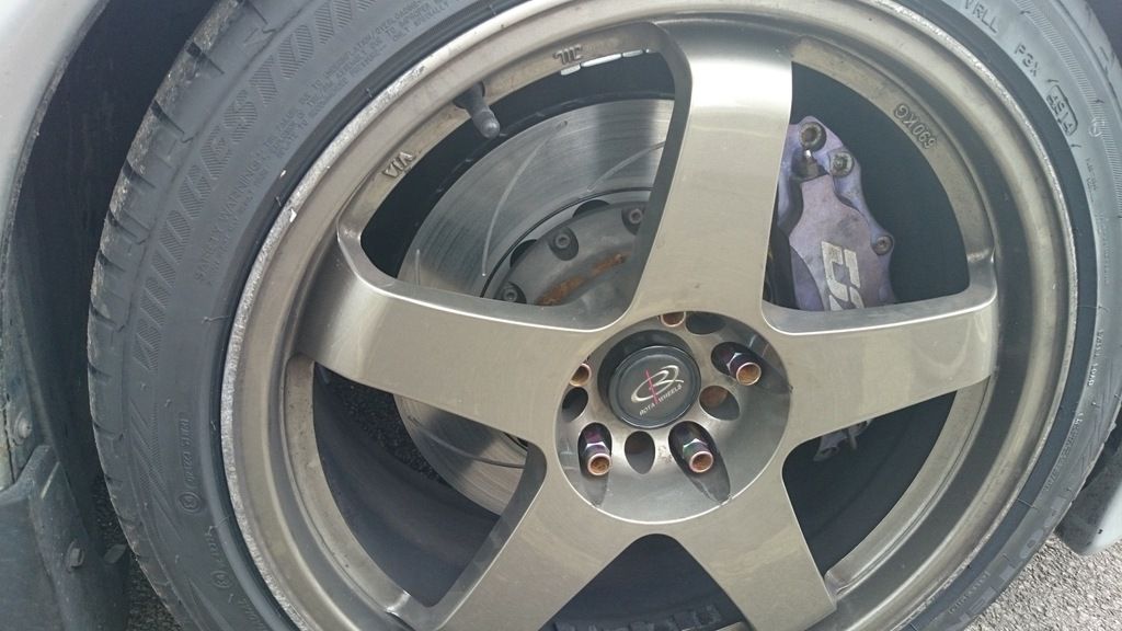

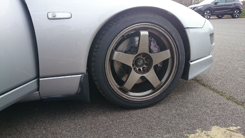

They fitted, So new front discs and yellowstuff pads and 4 new Bridgestone tyres, been an expensive day lol.
It's really sad but new tyres bring joy to me, car always feels great with brand spankers new rubber.
What have you done to my wheels?! ;) I can't just remember the colour code for it if you fancy getting them painted! I think it was toyota driftwood, there will be some threads about it!
Brake discs look good and new tyres always a sign a car is looked after.. Just out of interest, were the Falken 452's still on the front and some other Falkens on the rear? If so they've done really well!
I'd didn't damage the wheels , its done 150 miles since I've owned it lol. The rears are worse can see red paint through them,? We're they once red?
