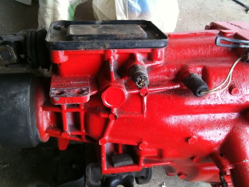

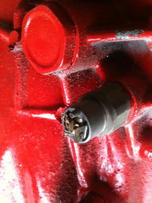

got my car in the garage after spending all early morning emptying rubbish into skip,
cleaned garage floor then it took 7 of us to reverse car up a slight slope into a garage.
after putting gearbox away securely i noticed something.............. something is perhaps missing from side of Gearbox.
pictures below taken from phone;
anybody know what part this may be?
Think it's the neutral switch. Why on earth have you painted your gearbox red?
i havn't lol.. came like that,
considering that it wont be seen i have no idea, maybe just to make purchase appearance better ... haha :p
by the way.... can i fix neutral switch or don;t i need it? it came directly out of another members zed when their engine went
Just reminds me of this, that's all. :rofl:
Neutral switch is required. The ECU uses the signal to adjust idle. I think it might be the reverse light switch. :confused: I am hoping I am not getting confused with the reverse light switch.... better that someone else confirms come to think of it.
Edited by FunkySi
yeah when i saw the gearbox i was a bit like........... "thats postman pat's gearbox"
cheers for the input anyway buddy, hopefully other will notice the thread and confirm to which switch it is.
will start my journal tomorrow :thumbup1:
Yes you need it. I will probably get shot down in flames but I was let to believe that when you put the car in gear the timing is advanced by this switch, in a manual when you put the car in gear the revs jump up a couple of hundred rmp due the timing getting advance by said switch.
Yes Neutral switch, and although not essential for a zed with a manual ecu as the timing is less effected than in an auto to manual conversion its nice for it to be in place.
Good news you do not need to replace it by the looks, just the cables and connector are missing. Make up a small lead, clean the connections and solder them back in place, done this many times, they often get damaged when the box is taken out and stored etc.
Jeff TT
The switch that is broken is 100% the neutral switch.....HTH:)
The car will run without it, but it will idle a little higher than normal because the ECU will alter the timing thinking the car is in gear.
Best to wire it in, but I believe there are quite a few not wired in when auto/manual conversions are done.
