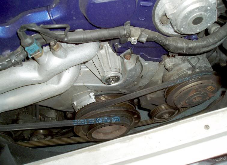

Lol I can see the problem. All the belts are still in place apart from the fan belt which is half on half off because a cog and raidiator fan seem to have come away. How much are these normally to replace?
Radiator fan? is the cog right next to this and looks like it will fit in? if so sounds like the viscous coupling, as for the belts there not expensive you can buy the set for around £30.00 do the belt tensioners look ok?
Yeah they look ok, the cog and fan has come away from a socket with the fan still attached
Ok i think you mean the main fan should have white blades (or at least mine has) the viscous coupling should be attatched to this and look something like this >
is this what has come away from the fan??
Yes thats it, but it hasnt come away from the fan. The fan and the coupling has come away from the main part of the engine. I'll try and go and take pics.
Ok well that is an important part really lol, it controls the fans rpm and kicks in at a certain point due to the solution inside, i'd say MJP should carry these and should be cheaper than going to Nissan :)

Apparently the water pump has snapped hence why the fan came away so I need a new water pump, so I figure i may aswell change the belts at the same time
The belts are an easy change and you will be able to get the pack from D.T.A on here not sure on how hard the pump is to change.
Thats EXACTLY what has happened to mine Jeff, and obviously the OP.
How did you go about fixing yours? New water pump and belts?
ahhhhh,, all makes sense, i suppose there is a lot of strain on that shaft when that fan is whizzing round so fast....
and fireblade did say he was "giving it some beans"
It was a customers zed, and yes we had to do a cambelt /water pump service to sort it out.
Jeff TT
I'm going to change the ancillary belts and water pump on mine to sort it. Cambelt was changed fairly recently. I'm probably going to put a new shroud on too as mine got slightly obliterrated by the coupling and fan coming off at speed
