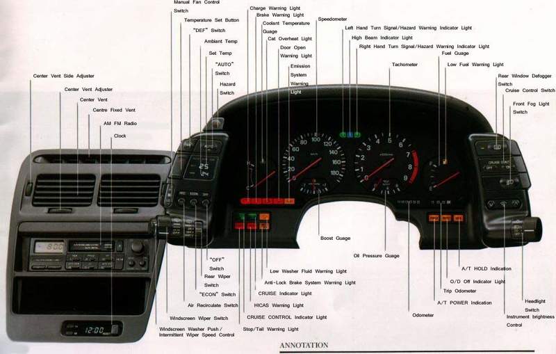

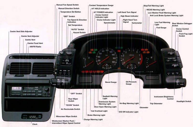

Daz, what is the difference between the 2 dash piccies?

Any on here?
Yep it is the cat warning light now to find out if its decatted a do imagine it is
thanks davert and also Dave spot on Al and Dave [to many Daves]
Cheerz,
Al.
Uk and import i guess

well that will be the "chicken done in the micro wave is ready" light.
Now just remember, marinade the chicken, baste, leave to stand for 1min and serve.
Stick your head under the car, see if its been decatted, if so, just take the bulb out, job done.
I love how they have labeled the "OFF" switch lol, like you wouldn't of know by looking...
Cheerz,
Al.
The 2nd picture is from a series 4 (i thinks):surrender: Air con control is different
