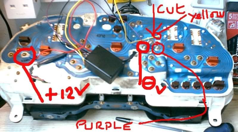

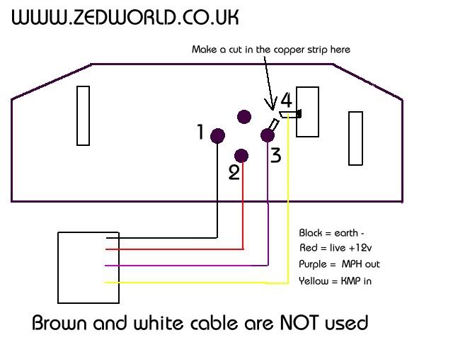

This should help, cable colours may vary and the second photo is an old, old one so the 12v + is shown in a different location but should give you the idea.
Jeff TT
Edited by JeffTT
yes cheers jeff, i see where your coming from cut the strip in the printed circuit.i was thinking of cutting the gearbox signal wire at the terminal bloc, would this have the same effect?
Yes you can cut the yellow/green wire to the block, put a bullit crimp on though, rather than inline, so it can be removed if needed at a later date.
cheers groover, i have two yellow /green wires to block,think ones signal in and the others out.traced printed circuit to 3rd wire in block for signal in. want to be 100% sure before i cut. yes bullit crimp good idea i was going to solder and shrink wrap.second hand unit so cant be sure its a good one.
