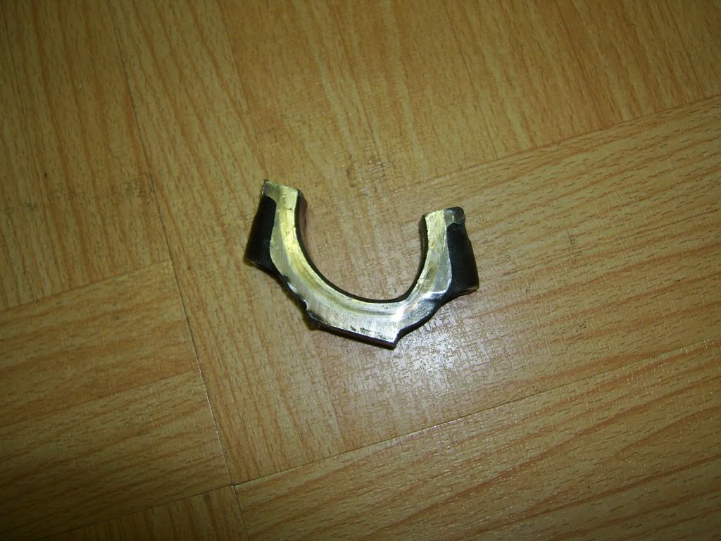

Red, just a question but whats happened? you say it hasn't suffered total bottom end failure, yet been advised that its safe to drive? are you experiencing any knocking at around 2500rpm? because if you are, id say the best option would be to leave it till the work is done.
This is the lower part of my piston after i blew the engine.

That was when I put two conrods through the oil pan lol, if I can find the other photos I'll show you how bad it can be, bare in mind, mine blew while driving, and managed to crack the cylinder block in two places, snap two conrods, one of which punched a hole in the oil pan the other smashed it's way through the block, the counter weights mangled what was left.
Not trying to scare you or anything but if your big ends are failing best just to not drive it at all, will lessen the damage you have to fix
