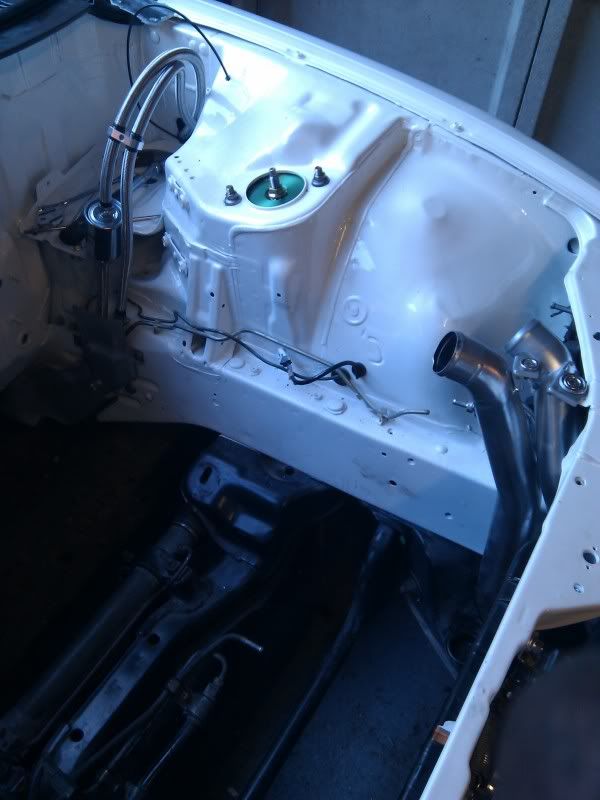

Im really struggling with a few bits so would really appreciate someone letting me know what these pipes do?
Basically there are two pipes that come up from the rear of the engine bay where the fuel pipes come in.
One dives through the passanger side bulkhead near a wire that I believe is the brake pad sensor? the other contines to run along towards the front of the car.
Thing is a whole lot of stuff has been deleted from this car and its making it very difficult for me to find out what things do or did because they removed the odd bit, stuck a hose on the odd bit, and blanked the odd bit. Nothing ever seems to have been completely deleted!!!. If anyone can tell me what the pipes were/are for it would be a great help.
Thanks
I'm guessing they are the vent pipes from the fuel tank to the carbon canister that sits behind the intercooler on the passenger side.
Have you removed the c/c?
There is no c/c that was partially deleted and all that was in the wing was a small air filter attached to a pipe on some hose.
Ahh thanks, I cut it back stuck some braided hose on it and passed it up under the battery tray and into the wing through a hole there. I will try and find a one way valve to put on.
