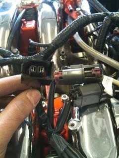

I have been fitting the new EFI loom and have got a connecter that I don't know where it goes to. Its on the bunch with the AAC Valve, Exhaust gas sensor, VTC solenoid, Injector and coilpack.
Here is a pic of the connector below. I ve looked at the online manual and it doesn't seem to show this connector.
Anyone know where it goes please?

I think its the connector for stock boost solenoids. If you fit an aftermaket boost controller these have to be disconnected / bypassed. Should be a plug either side of engine.

Thanks Kev. That's what I thought it was first of all, but found that to be another connecter which is on another part of the loom.
I'm starting to think it may be from something I've deleted.

ignore that plug.Thats an american loom and will have some plugs the uk/jdm cars dont use.As your fitting a boost controller,cut off the unwanted plugs and tape up the wires to keep the engine bay looking tidy.It is possible to do the inside part of fitting the loom with the dash in.fiddly but possible.
Thanks for that Jimmer. Just out of interest what is the connecter for?
