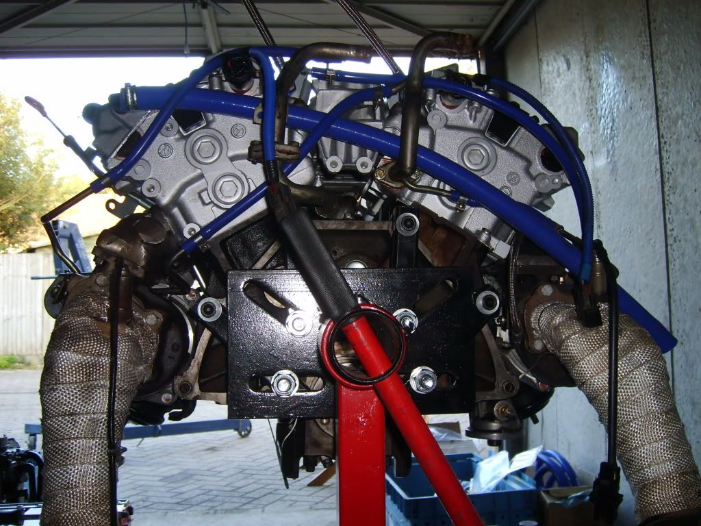

I have just put together my engine stand which arrived today and im going to need the bolts to attach it to the block, im thinking 10x100mm if anyone knows for sure please let me know.
Also because of the pipe on the rear of the engine, it seems to leave only 4 mounting points.
Anyone with any pics of the rear of the engine on a stand will be great.

the bolts to use would be the same thread as the gearbox bolts. the engine will be fine to swing on your own, although i would recomend an extention pole to ease the strain. N.B. the engine wont spin if the tub elbows are attached

The top arms on my stand seem to catch the water pipe top left, so might have to use the middle and bottom bolt holes.

You can use bolts as long as you like, as long as you have plenty of decent sized washers to pack it out mate.... That's what i did anyways....
