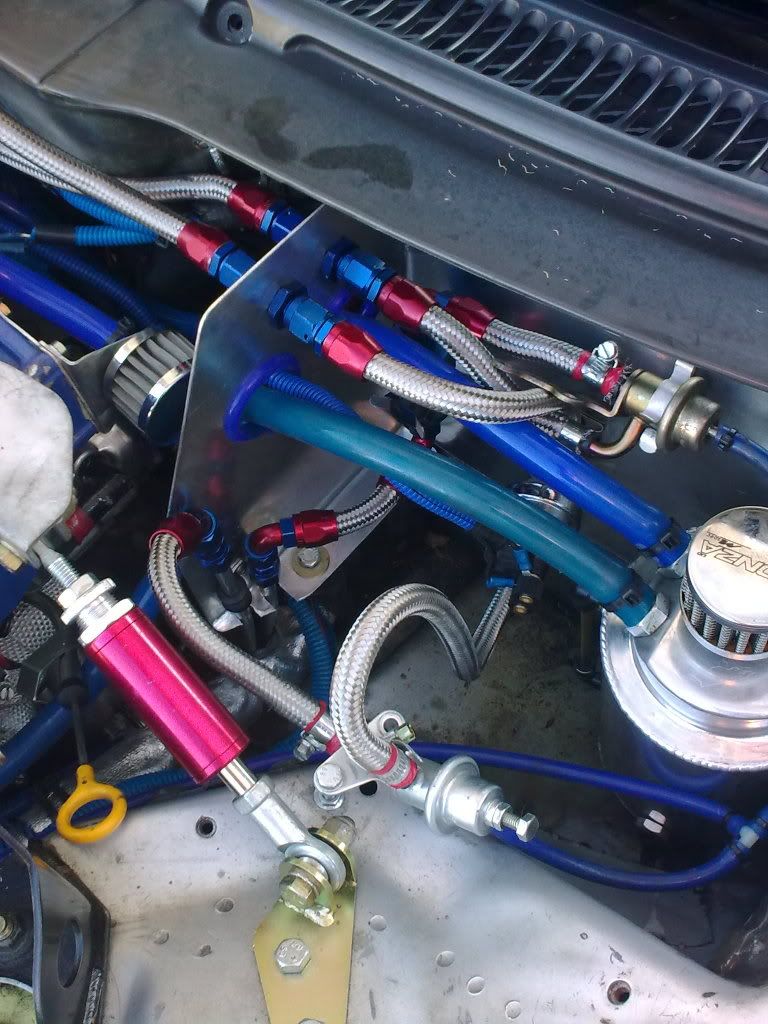

I have the larger of the two SARD FPR fitted as pics below. They are not cheap though lol. Two gauges fitted to fuel lines.One intake and one out.(Don't ask lol).

If you are getting your car mapped then the only reason to fit an AFPR is if your injectors are maxed out at stock pressure. If they're not then it's just wasting money, you adjust the fuelling from the fuel map, not the injector pressure!
They're often fitted if the car is not mapped as a crude way of enriching the fuelling but it's not the right way to do it - adjusts it everywhere.
