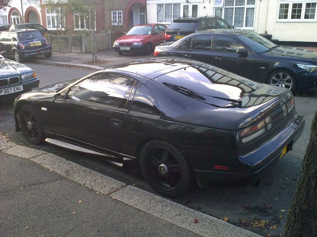

The answer presented itself in the form of a black series 1 swb which had been partially broken for a manual conversion and a few bits and bobs
I collected the car on sunday, and a big thanks to rigs
The car needs a drivers side wing and a front bumper along with a respray of the rear hatch a new interior and alot of tarting up.

I gave the car a quick wash tonight to see what lies benieth and to give it a bit of a clean before i work on it.
looks better than i thought. i tried to take some photos but its too dark
