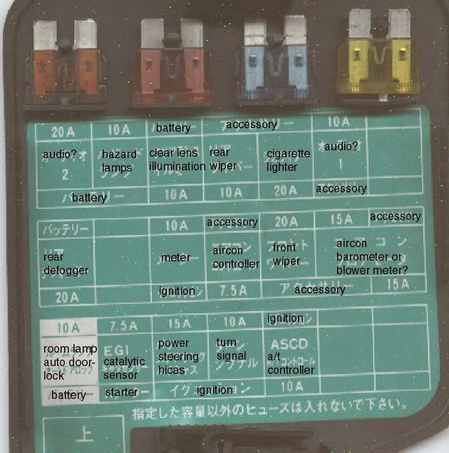

Does anyone have a pic with the fuse box translation? Mine is in japanese...

here you go mate
