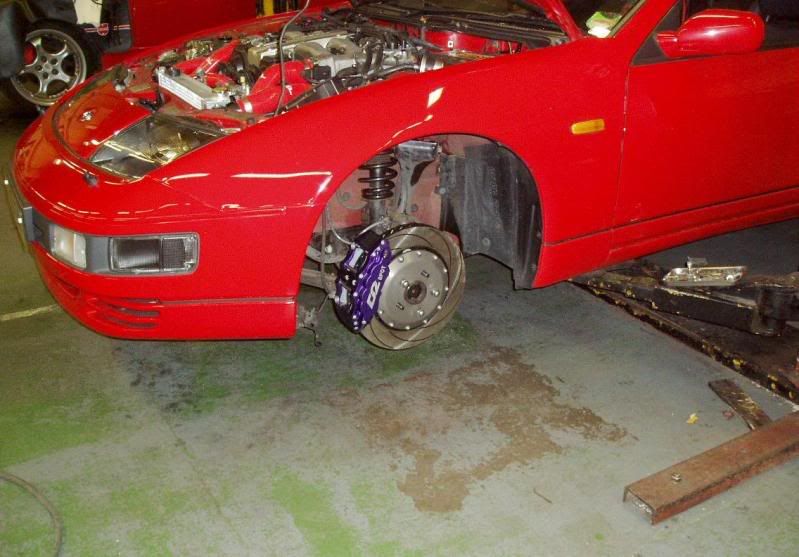

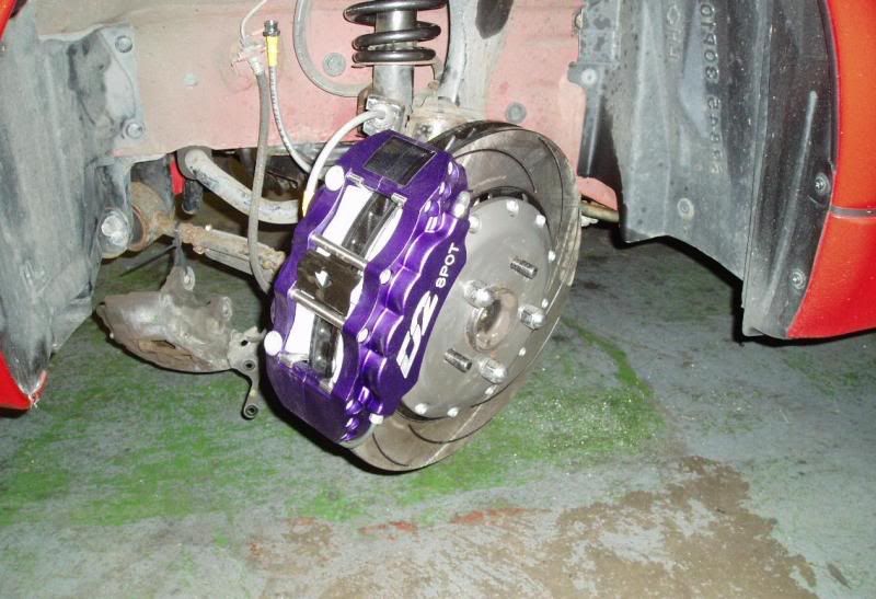

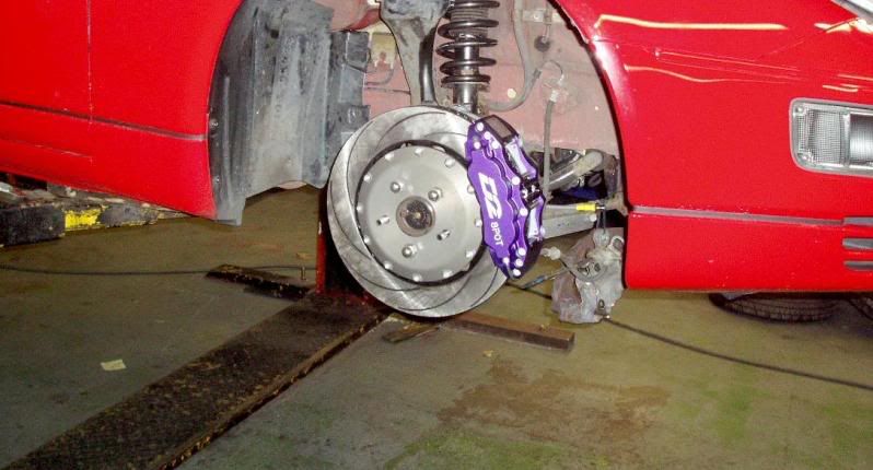

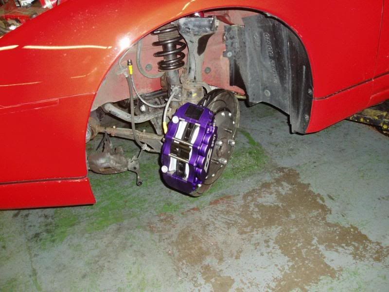

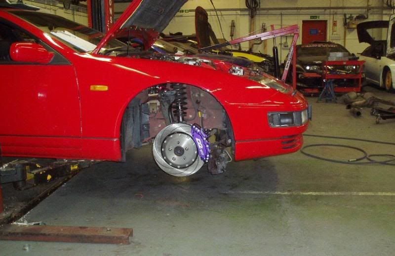

Ok if any of you zedders are presently looking for brake upgrades I cannot recommend enough the quality of the D2 big brake upgrade, having just fitted an 8 pot front and rear callipers & disc upgrade from D2 ( see pics. below) I can certainly say the fit is excellent, the relocation brackets and supplied bolts etc. are all top grade.
Fitting the kit is very straight forward and the kit not only contains everything you will need but even spares washers and brake line adapters, the cost does vary slightly depending upon where the kit is bought from but expect to pay between £850 to £950 for the front kit and slightly less for the rear.
The kit use a bell type disc which gives excellent clearance but does need at least 18” wheels for total clearance. The relocation bracket is a single piece cnc machined block and hence is very accurate and well made.
The fixing bolts are all made from high tensile steel and look to exceed requirements which is always reassuring, as of yet they are not road tested and will update this thread after then, but so far given the price and build quality they look like top value for the money.

High Jeff, I was looking at these the other day at you know who,s before you got them and yes they are a very top notch kit.:bow::bow::bow: I have the 356mm bigger disc set on mine only KSport. Which are exactly the same just badged different. They are really good brakes.

I'm curious to know how these kits affect the ABS set up?
Mmm..well the abs sensor works off the hub reluctor ring so will read the rotation exactly the same.The ABS ecu will of been programmed with the standard brake set up dynamics, so it could be possible for the changes in braking dynamics to require an ABS ecu update.
But having said that, manufacturers are very good at building large amounts of redundancy in items such as engine ecu mapping and possibly the ABS programing and would hazzard a guess it will be just fine, but once fully road tested i will add my findings here.

It will mess it up a little im affriad. Well it has done on mine. but only from 10mph down its really keen??
Apart from that there amazing :cool:

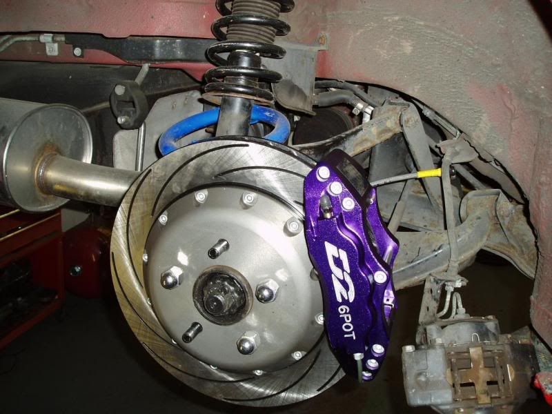

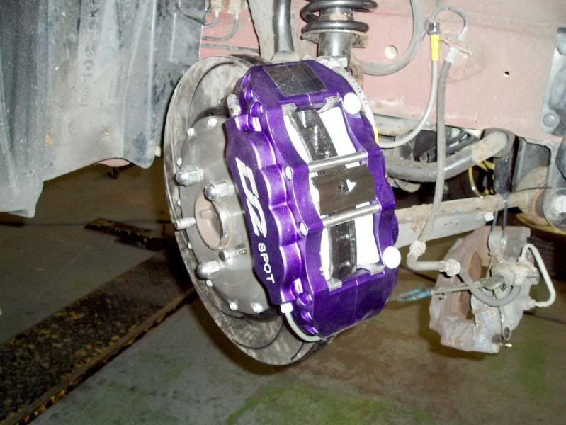

Here are the rear brake set up fitted.
Jeff TT
Won't the old caliper catch on the road a bit :tongue:
Seriously though, looking good and must have a improvement on the braking..
