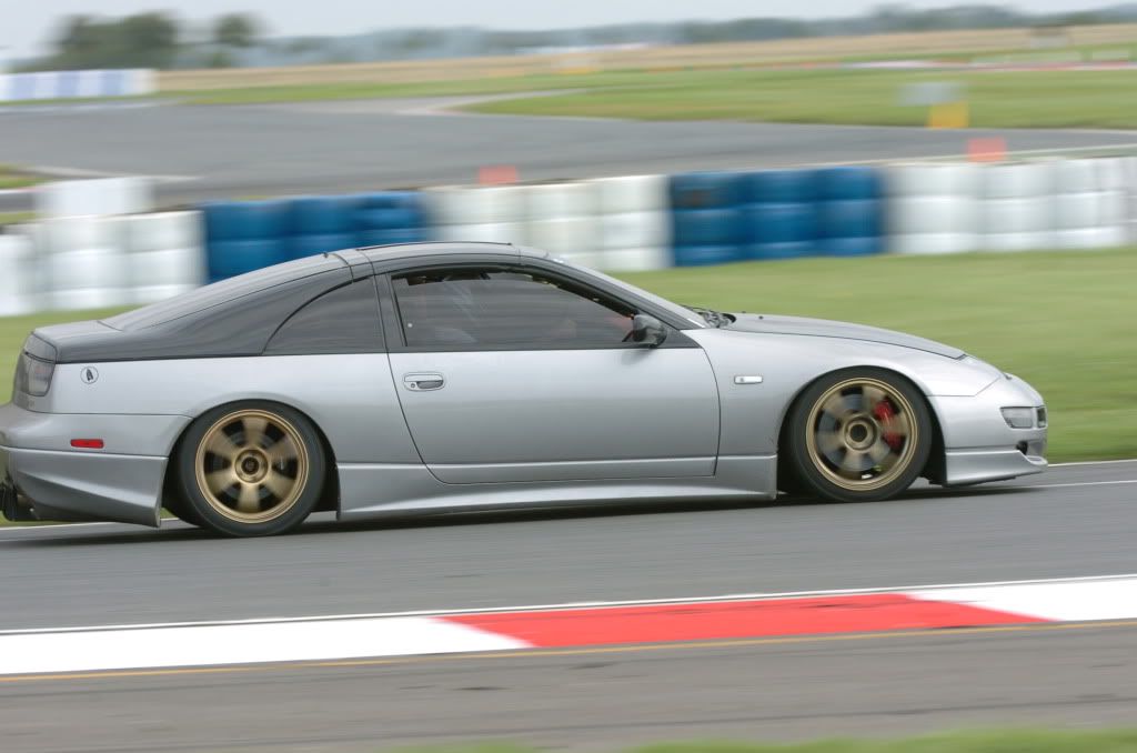

just for proof, does this look like the tyre walls are folding over on the edge? I think not, and this is at full lean as you can see the sideskirts are almost touching the ground lol
I bow to your greater experience here J1mmytt!
Think I must have missed the bit where you said you were using special track tyres rather than normal road ones! Or the fact that you have 2.5 degrees of negative camber on the front. That must be fun on the public road!
My point was based on the assumption you were using road tyres in a track day application on a "normal" car.
Even the Toyo thing you quote gives a range of 27 - 35psi cold for a very heavy car which lets face it the 300zx is. You setting at 24 is even below that range but I see that you didnt start with that but reduced it to that when they were hot after starting with 35psi cold. I guess that on cool down they would have then been well soft. Toyo seems to be saying 37 - 40 psi hot is the right range
I still disagree with:
" the less pressure the less the surface tyre patch heats up vise versus. "
I think its the other way round.
Anyway your points are interesting and your car looks great at full tilt!
