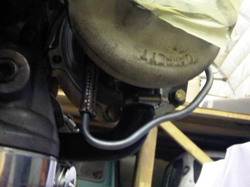

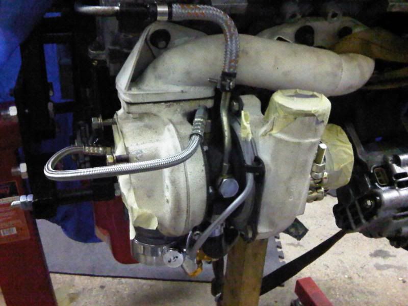

After loosing or throwing my water and return feeds to the turbos, ive came up with this idea do you think it would work???

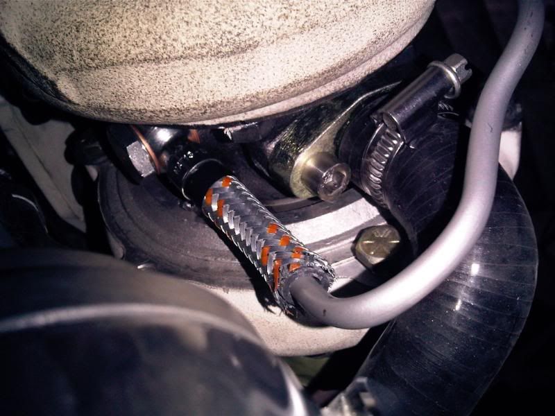

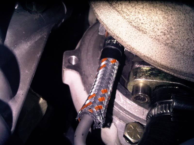

As you can see ive used a little bit of braided hose to connect the banjo bolt to the what was oil feed pipework with a little bending into shape:p, Im hoping the hose will withstand the heat. Do you think i will have any problems??
Cheers Dan

if all else fails Dan, i think they should work. might be worth pulling the hard pipe away from the manifold though (last pic)
I say get the pipes off Gonzo, the braided hose is probably epdm which is only suited upto 120-130C so next to a manifold will fail I would think.
Thanks for your replies guys :-) Is the top hose in the last pic connected to the right water pipe leading to the rear of the engine? I try reversing the hard pipe around hopefully it will be enough space from the manifold.
