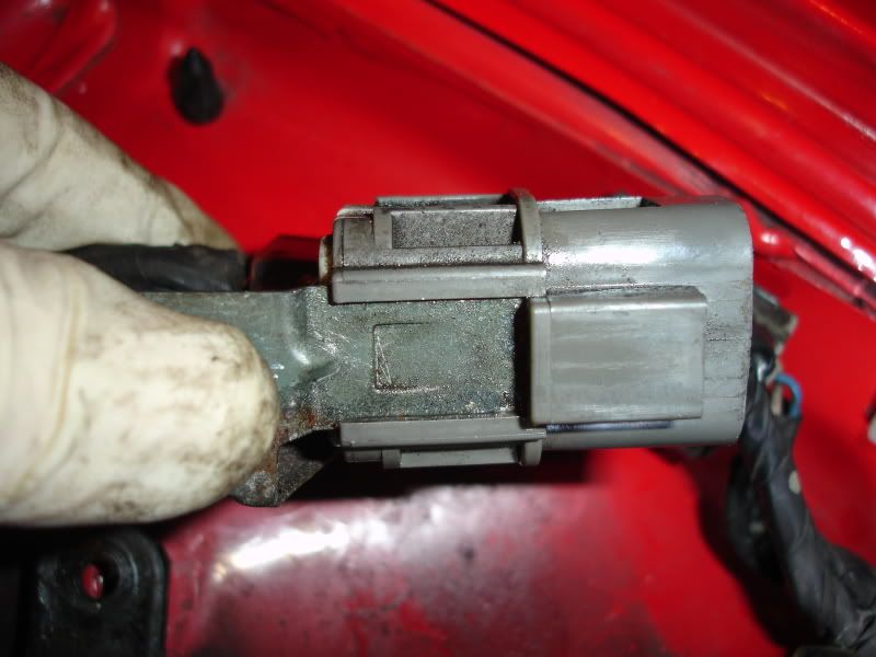

guys trying to get these 2 apart as I need to remove mu fuse/relay box.
As you can see the grey one came apart no problem, the brown plug is being more difficult. I have tried the obvious of pushing down on the small plastic tab on the connector whilst pulling apart but no joy! Am I misssing something or do I have just just pull harder?
On the 2nd pic. how does the socket come away from the metal prong?
Tried pushing the tab in from hte under side with a flat bladed screwdriver but to no avail!! :smash:

Just push down with the flat blade as you're doing, you should hear a little click then just pull. The connectors have probably oxidized and stuck together.

wd40 n a flat blade screwdriver, use a little leverage by twisting the blade whilst pushing down on the tang thinggie
brown one put a flat blade screwdriver between the two haves (plastic tab and the other half) and twist while pushing it down.
always worked for me on a stubborn connector

Cheers santa, twist the screwdriver did the trick, now if only I can get the last bolt off that holds the relays/fuse unit to the inside of the wing I'd be done.
