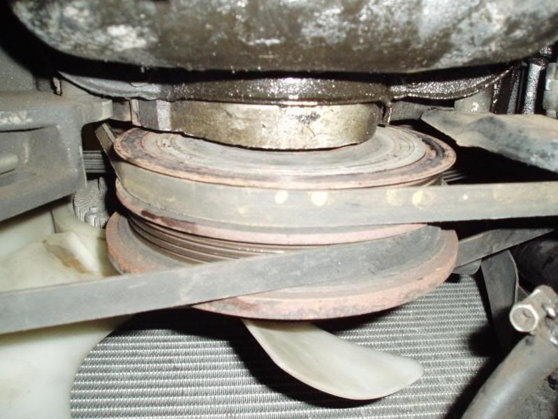

With the engine running there was an awful knocking sound from low down at the front of the engine, with the engine switched off a quick inspection did not immeidiately reveal anything.
However with it running the area where the noise was coming from was more obvious but then its suddenly stopped making any noise, weird, revving up the engine however reproduced the sound again and it was spotted.
The picture below shows what it looked looked like from below when there was no nasty noises.

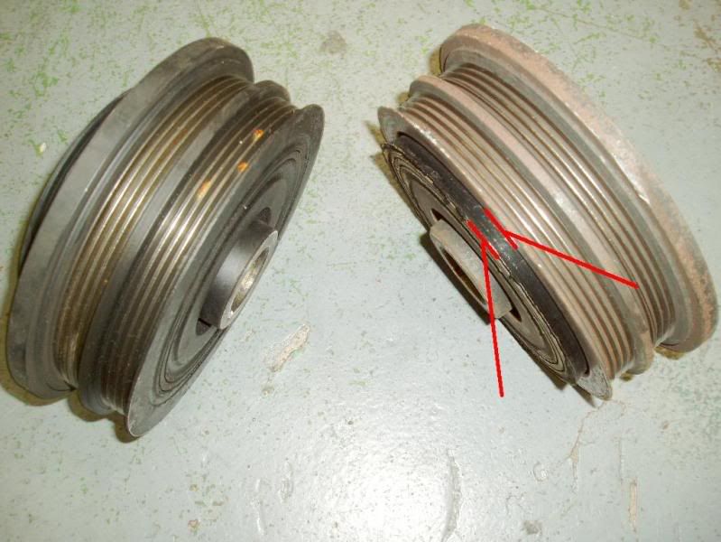

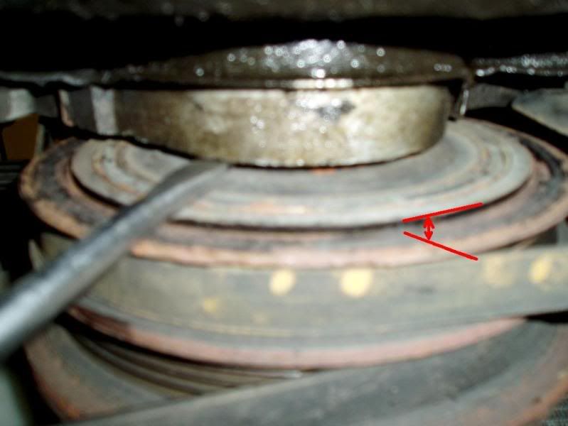

After tracking it to the pully, a bit of pressure applies showed the inner damper section was loose, see the outer ring markings where it had rubbed on the front engine/ oil pump cover.
Much clearer now its removed from the engine, you can see how the inner vibration damper had completely detached and moved within the outer pully section in comparison to the good pulley on the left.
So easy for parts like this to get overlooked as on the face of it they seem to last forever..but they do not.
