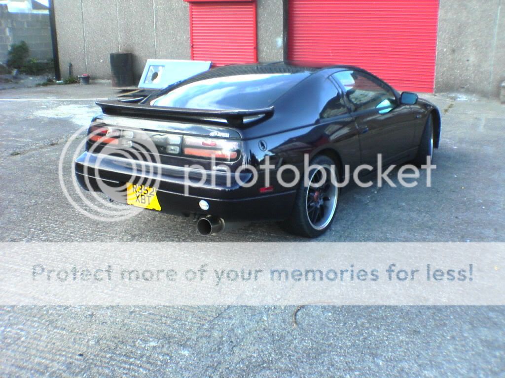

Can zed shaun get back to me regarding the inverter please for the rear glow panel...
Can anyone else advise to as what the problem may be?
Rear panel does have wires running to it but no glow...
