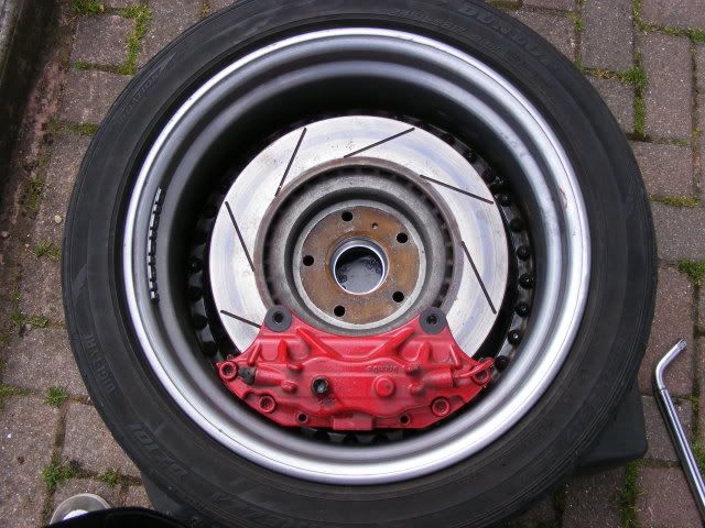

If so simply do this as I did and you will see if they clear.
evo brakes can fit under 17's so unless your wheels have a very high offset then you will be fine bud

Circumference wise you'll be fine as you can see by mine under 17's but you may have to space off for spoke clearance depending on offset. I did.
