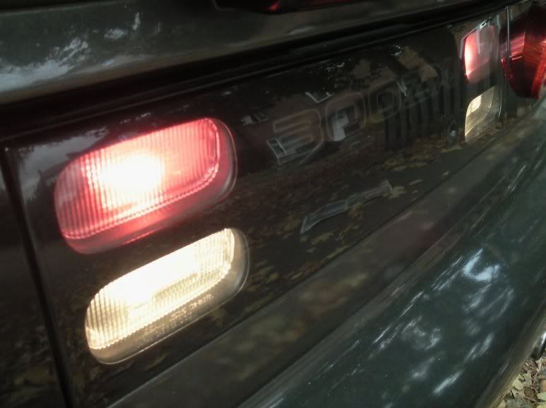

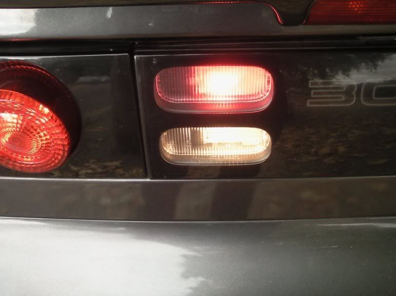

Here's another option (bulbs don't look as pink in reality).
This way you keep a fog and a reverse light on each side of the car...
elo pal,,,how you manage that????its one bulb which lights up the 2 lenses??please advise
Oh just me being tricky. I siliconed a blanking plate halfway between the two light outlets.
drilled another bulb hole in the sectioned off area and used chrome spray for extra glow.
The reverse lights plug in as usual but I connected the stand-alone fog light to the newly added bulbs :)
oh just me being tricky. I siliconed a blanking plate halfway between the two light outlets.
Drilled another bulb hole in the sectioned off area and used chrome spray for extra glow.
The reverse lights plug in as usual but i connected the stand-alone fog light to the newly added bulbs :)
you have done a good job,much prefer the lights like that, look professional,can you come an do mine????lol
Cheers mate. They're really easy to do - just use some thin plastic etc to slot into the cluster, bond them in, spray silver inside and drill holes for the red bulbs to go in. Job done!
What Wattage of red bulb did you use? Also what type did you fit?
They are 21w from ebay, universal use (no make listed).
