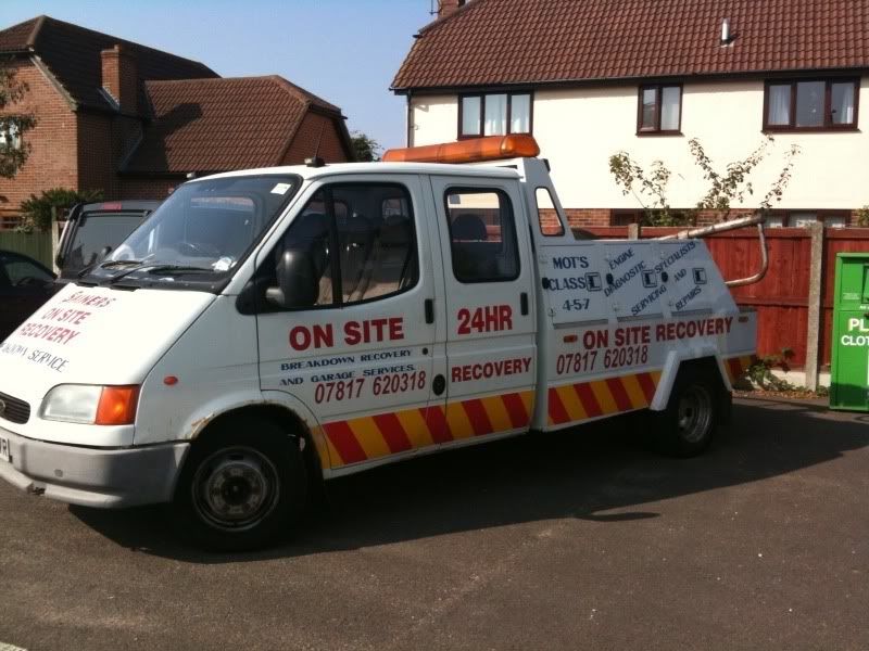

car is being hoisted by the rear on a recovery truck on the weekend. Is the steering wheel lock strong enough to keep wheels straight?
how else can i lock the wheel to stop it swirving?

the bloke lending my uncle the track does it as a business. it has the bars at the back that raise half of the car off the ground.
my car is auto and so i can't hoist it from the front unless i want to disconnect the prop (which i cannot do)
also the bloke who owns it said when he drops it off saturday he will put the car up on it for us so we can just drive it away. he also mentioned it should be carried from the rear

this is the truck

i found this info in the end............................
QUESTION: I am wondering if I tow a rear wheel drive mercedesC230 on a tow dolly if I have to disconnect the drive shaft to do so. The vehicle is an automatic and I'll be towing it about 1400 miles. Thank you
ANSWER: Well the Mercedes C230 comes in 2 versions... Rear wheel drive and ALL WHEEL DRIVE..
Automatic or not it would not matter if it is the ALL WHEEL DRIVE version it needs to be all the way off the ground...
I would look at getting a trailer for the vehicle to be safe and to prevent any damage from happening to the transmission...
Using a tow dolly on the REAR WHEEL DRIVE version, it would be best if you loaded it so that the rear wheels are on the tow dolly to prevent damage to the transmission.
---------- FOLLOW-UP ----------
QUESTION: Its a 2 wheel drive. How do I keep the front wheel straight for that long of a trip? Will the ignition lock hold the wheels in place for that long of a trip. The cost of a car carrier is twice the money as a dolly.
Answer
Yes the trailer costs more than the dolly, but you have to also consider if the vehicle will have enough ground clearance when in tow backwards.
Not good if you are going to tear the front bumper or other parts there off...
As to securing the steering wheel straight, the ignition lock is not strong enough to depend on it totally.
Its hard to explain, but most tow truck drivers do use a strap (like those motorcycle tie downs) from the brake pedal bar, or a bar under the drivers seat, and wrap it around the steering wheel one or 2 times and then back to the same point it is at on the other end. Then tighten it up and you have a better securement method.
And you can also use the seat belt though the wheel and then locked into place as an additional safety...
