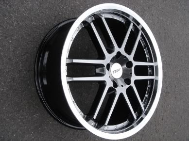

another thing id say with whatever brakes you go for is to watch the offset onto your tsw's... getting the brakes to fit inside the circumference of the wheel is one thing but clearing the spokes of the wheel can become a whole new battle!

right, cheers Joel. I have 19's on but as you say its the offset.How the fook does everyone work this out lol

These should do nicely I think I will be going for as an agressive offset as poss too, if 20 works with yours that might be a good place to start, I have a 12mm spacer that will be perfect. By the way what size are your front tyres ?
Joel,
them spokes are quite far out to the rim with no dish so they should be grand... my front tyres are 225 40 18
Every wheel has an x-factor which is how far the spoke is from the centre line, Find out your wheels x factor then calculate from where your calipers are at present and how far the new caliper extend out.
Offset also depends on the wheels width, if you had an 8inch front wheel and compared it to joelys which i think is 8.5 inch wide there is a 1.3mm size diference which is 7mm difference in offset so your 8inch wheel will stick in an extra 7mm compared to the 8.5inch wheel, thats almost 1cm which is a visable difference, just something to think about :D
