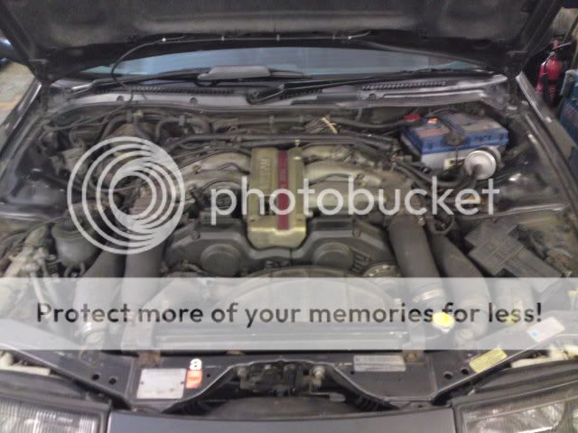

The downside is the car ran on safety boost this morning, probably due to code 34 (det sensor), which we obtained last night. I've also ordered a new coolant temp sensor, so will hopefully get rid of the code 13 as cleaning the connectors didn't work 100%
Well done, that looks OK, nice plate too. The resistor det sensor mod tends to be permanent as a replacemnt det sensor is quite an involved job, i.e. plenum off, unless you reposition it. It is usually the harness that fails and not the sensor which is a bit more easier to replace. Loads of help on here, keep plugging.
Thanks 'old zed'. Matt hasn't got round to checking the harness yet, should be some time next week. If the sensor itself has gone though, he'll be relocating it for me as per the forum sticky :)
She's still running on safety boost, even though the ECU shows code 55. Having read alot about det sensors on the forum, I'm convinced the det sensor/wiring is the culprit so I'll get it looked at this week. N/S manifold is definitely blowing too...that must be a bitch to replace...does the engine need to come out for this?
