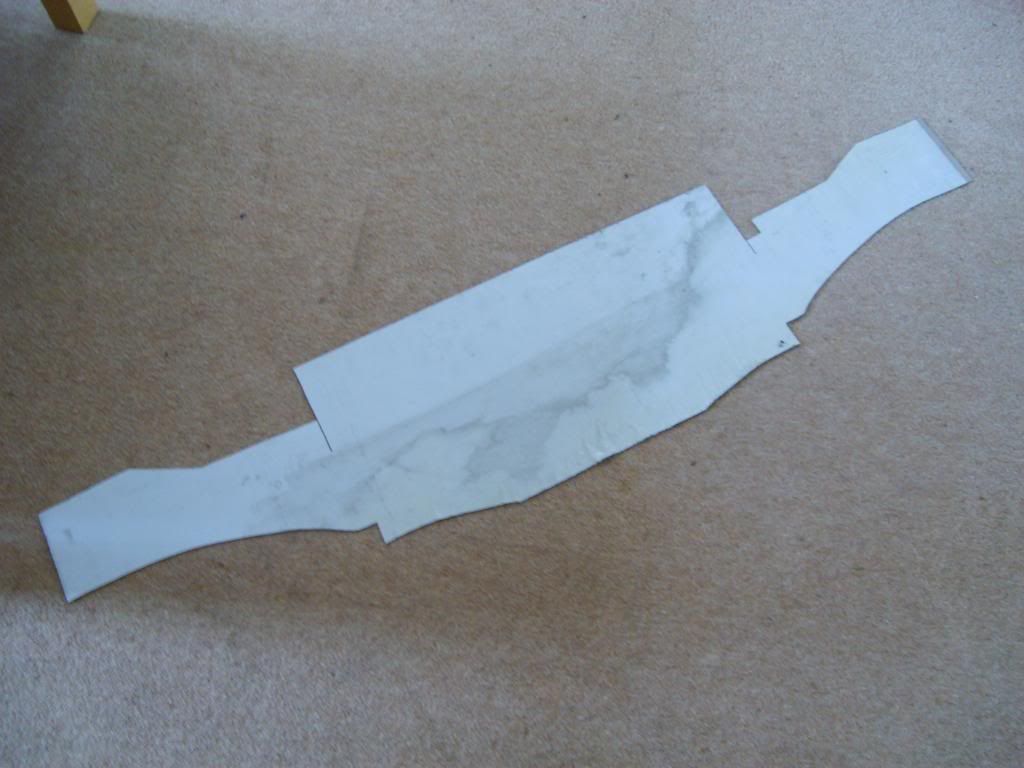

well, i had a sheet of ally lying around so i thought i would make up a slam pannel.

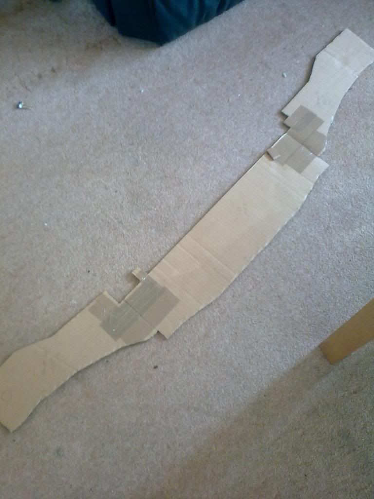

thanks to Wendy for the loan of his carbon pannels, i was able to make up a card board template...
then draw the shape and cut it out, Topless gave me an idea about covering the top of the rad so, i left the center for such purpose...

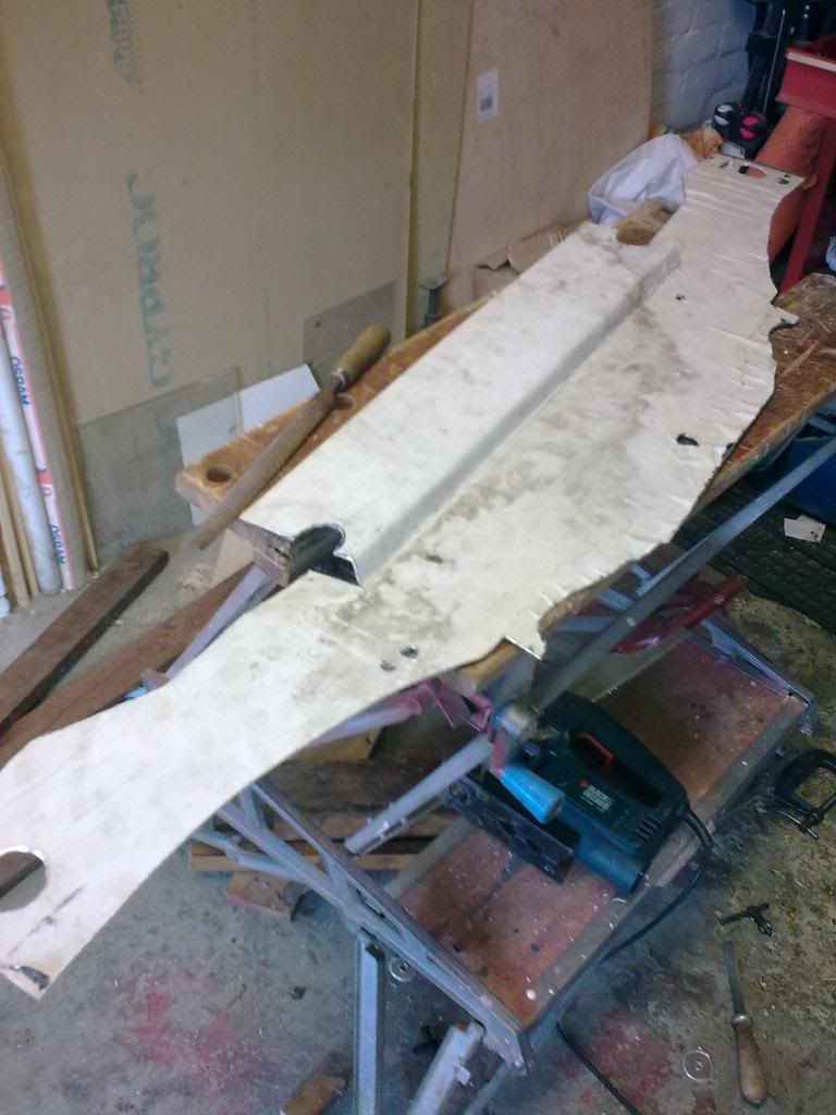

bending the ally was the trickyest as i dont have a line bender but, with a few carefully chosen lumps of wood and a handfull of G clamps, i managed it...

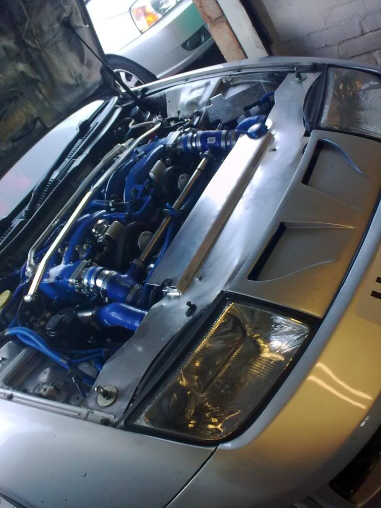

just a little bit of filing and making good and its ready for fitting...

looks ok, need a bit refining but overall a good job, will this help aid the cooling of the rad as it will direct air more through the rad from the headlight panel?????
thats the idea but i think these are mainly for show or for covering up dodgy paint work :whistle:
Looks well made marcus :D
thanks for the comments guy's, it does need a little fetlling around the top of the rad but, im going to leave that until i put a vent in the bonnet, then work out a way of making a complete rad duck to channel the hot air up through and out.
i dont think it will make a blind difference to the air flow, i just wanted to cover up the "dodgy paint work" as Jimbo so eloquently put it :D

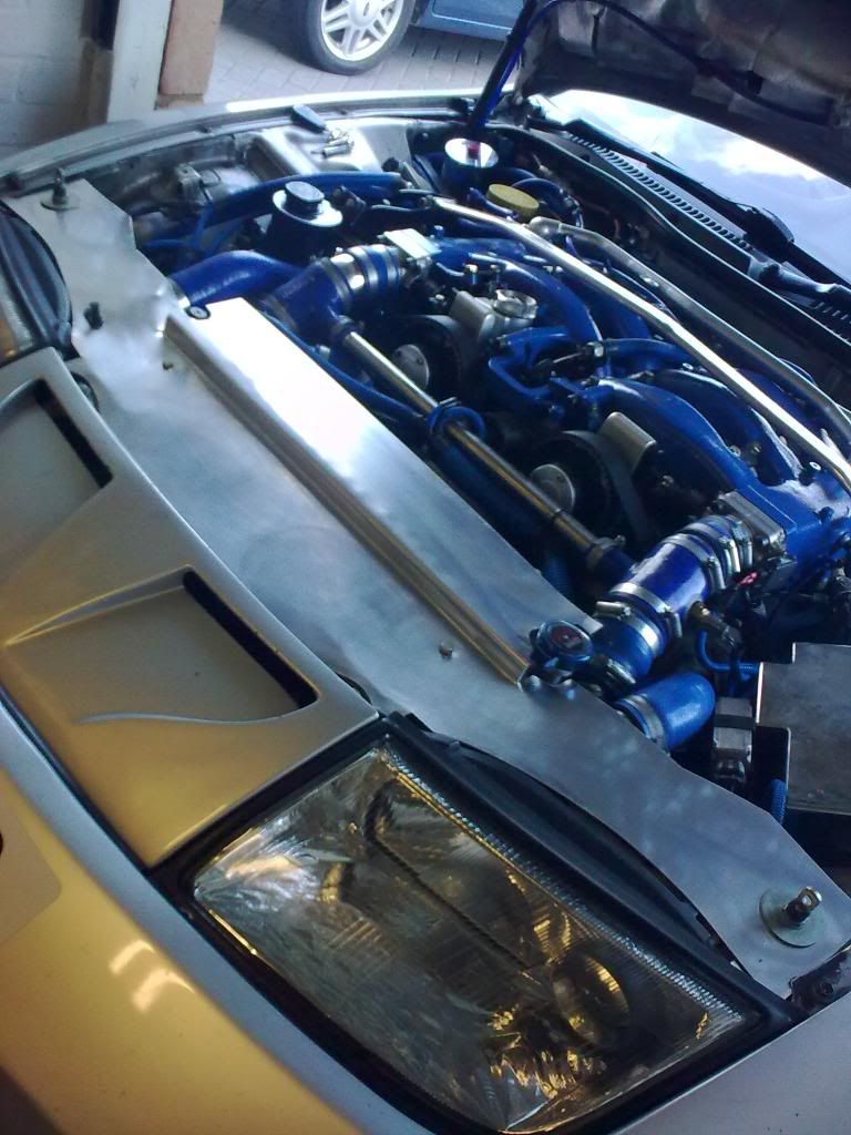

looks good mate. What about the bonnet catch tho?
the pins are a clue!lol
dan.:)
spot on ;)
did away with the stock catch ages ago :D

do you still have the cardboard cut out mate? Might be intrested in attempting my own aswell.
